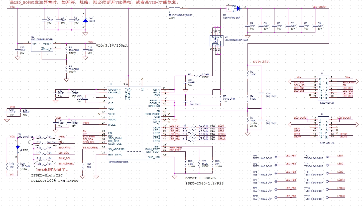

Our customer is meeting an urgent issue about LP8863-Q1, they have produced 20pcs to driver LED screen, and find 5pcs screens is dim, and the brightness is non-uniform.
1.The LED Dimming mode is PWM, max current is set as 102mA, PWM duty cycle is 85%, and one device driving 4 channels of LED, leaving 2 channels idle. When testing the voltage of driving pins, LED0 is 3.64V(square waveform), and other 3 LED pins is 10V, and the normal boost output is 24V, so LED1, LED2, LED3 is not normally working, then taking apart the shell of load LEDs, and find only one LED is lighted.
2. Lighting this abnormal LEDs device in another testing equipment, the equipment is op + transistor to produce a constant-current source, and put the LEDs series of constant-current source, the testing result is 4 channels of LED is all lighted, but one channel’s current is slowly rising to current configed.
About the testing results, our customer want to know if there is a special protection method in each channel of LED, and the reason of 1 abnormal LED channel leading to the other 3 LED channels abnormal.

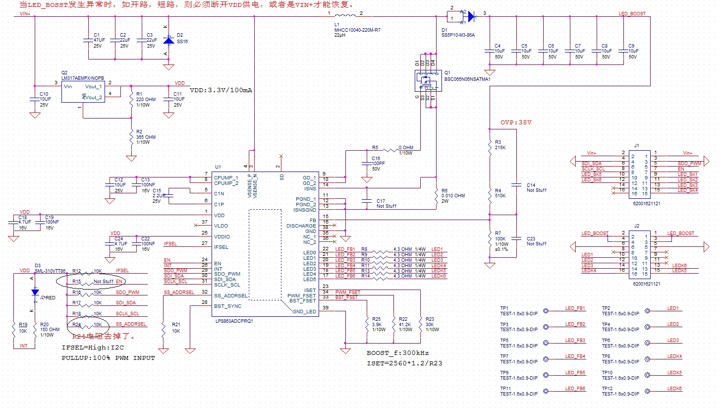

    It is quite difficult for us to figure out the reason with your description above. Would you mind providing more details about that? And it's better if you can share the schematic as well. Thanks.
  • Hi, Shirley,
    The schematic is as following:

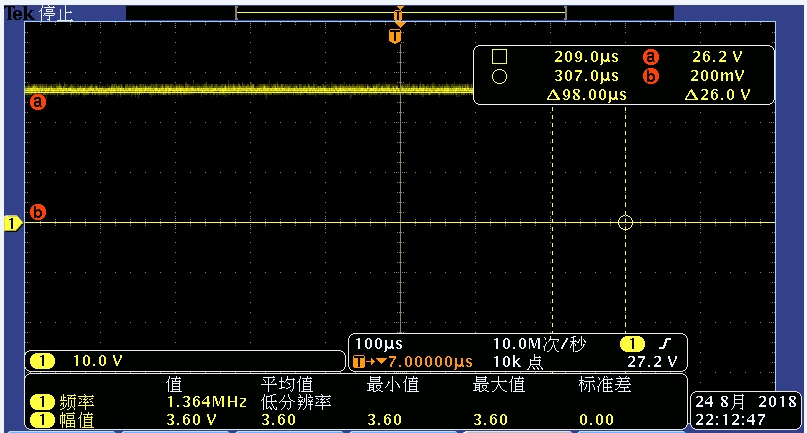

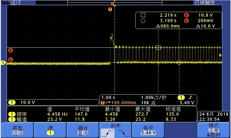

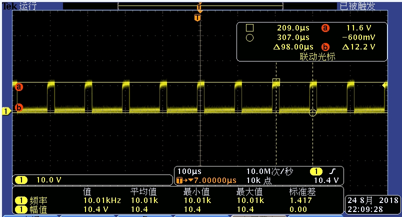

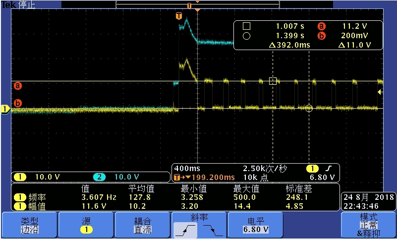

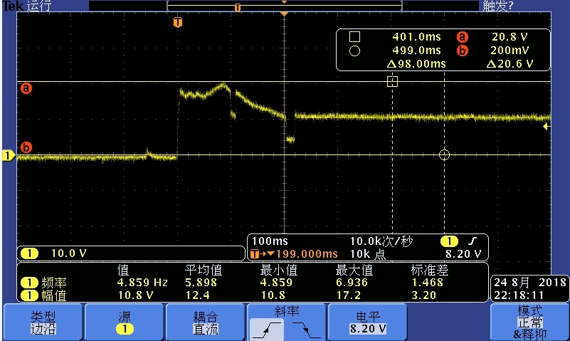

    They tested LEDA and LEDK in LED series, 7 LEDs per series, and the following waveforms are one series is lighting, the other three series is not lighting.
    They want to known the reason why LP8863-Q1 can just light up one series, and what's the protection method behind? Is the impedance among these series? and how to eliminate this protection method?
    1. LEDA voltage of normal lighting series while working.
    2. LEDK voltage of normal lighting series while working.
    3. LEDK voltage of normal lighting series while starting up.
    4. LEDK voltage of abnormal non-lighting series while starting up.
    5. LEDA and LEDK voltage of normal lighting series while starting up.
