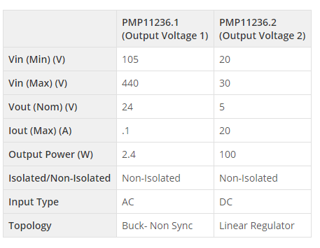

Hi, this is a voltage regulator and in the parametrics side of the description it says " Vout is 24V" for AC Input. I have to use it 220V AC Input and 5V Output. Is it possible for this product.

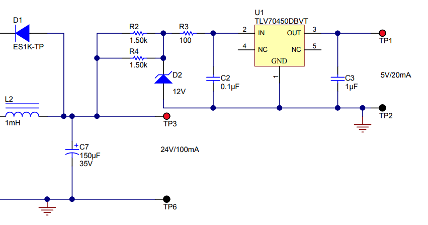

Hi Osman,
Thanks for your interest in UCC28881. Yes, it is possible to configure UCC28881 for 5V output. For reference, take a look at section 9.2.1.2.7 of the UCC28881 datasheet for how to configure the output voltage:
I would suggest using webench to get an idea of what the design needs to look like: https://webench.ti.com/appinfo/webench/scripts/SD2.cgi?ID=211426::power::ben.lough@ti.com
