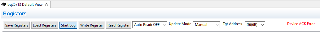

The first time I connected it to the power supply, VSYS voltage (output) is 3.6V, not 5V. In addition, I tried to connect it to the PC with the EV2400 kit and it says "Device ACK Error" when I try to read register by I2C.
It seems like the board is not okay or I missed any step.
I have selected correctly the charger and I have connected a real battery to the board:
Does anyone know which might be the problem?

    For what it is worth, with my EV2400 I found that I get "Device ACK Error" if the connection and power-up sequence is wrong.
    I have to power-up the board, connect the EV2400, then plug the EV2400 into the PC via USB, then start the software.
    Then it can read and write the registers ok.
    PS: When it came to do my own PCB I found that the I2C on the EV2400 was picky about the value of the pull-up resistors on the SCL and SDA lines. 10K resistors worked, but 1K resistors didn't work, and the symptom of this was seeing a "Device ACK Error" in the software.

    I realized that the problem is the EV2400. The PC does not recognize the device.
    When I connected it to the PC, the leds of the EV2400 are ON, but the PC doesn't sounds(when you connect an USB it has to sound).
    I have open the box, and I install the JP7 and suddenly the PC sounds, but li8ke an unknown device. If I disconnect the jumper, the PC sounds again, like unplugged usb.
    I tried to update the firmware, like your workmates said in another forum, but it shows:

    I can't send you any capture of the I2C because the PC doesn't recognize the EV2400, so I have not communication and I can't connect it to the BQStudio. It shows: no free adapters are available for use on this system.
    Anyway, I have connected it to the I2C side and selected D6(6B).
    Regards.
