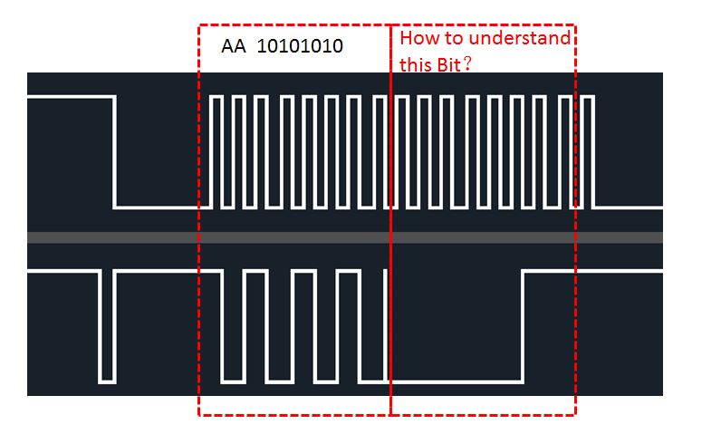

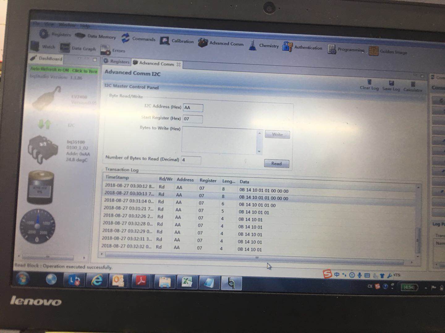

I use EV2400  to communicated with my PCM by bqstudio.
I send the command 07 to read the terperature as following picture shows.

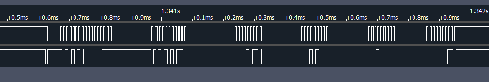

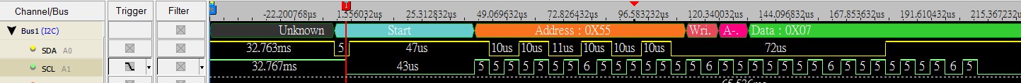

And I read the waveform with a logic analyzer  as following picture shows.
I know that the last five sets of data represent  07, 0B ,14, 10, 01. But the first data is not represent  AA .
And who can tell me the reason of this issue?
