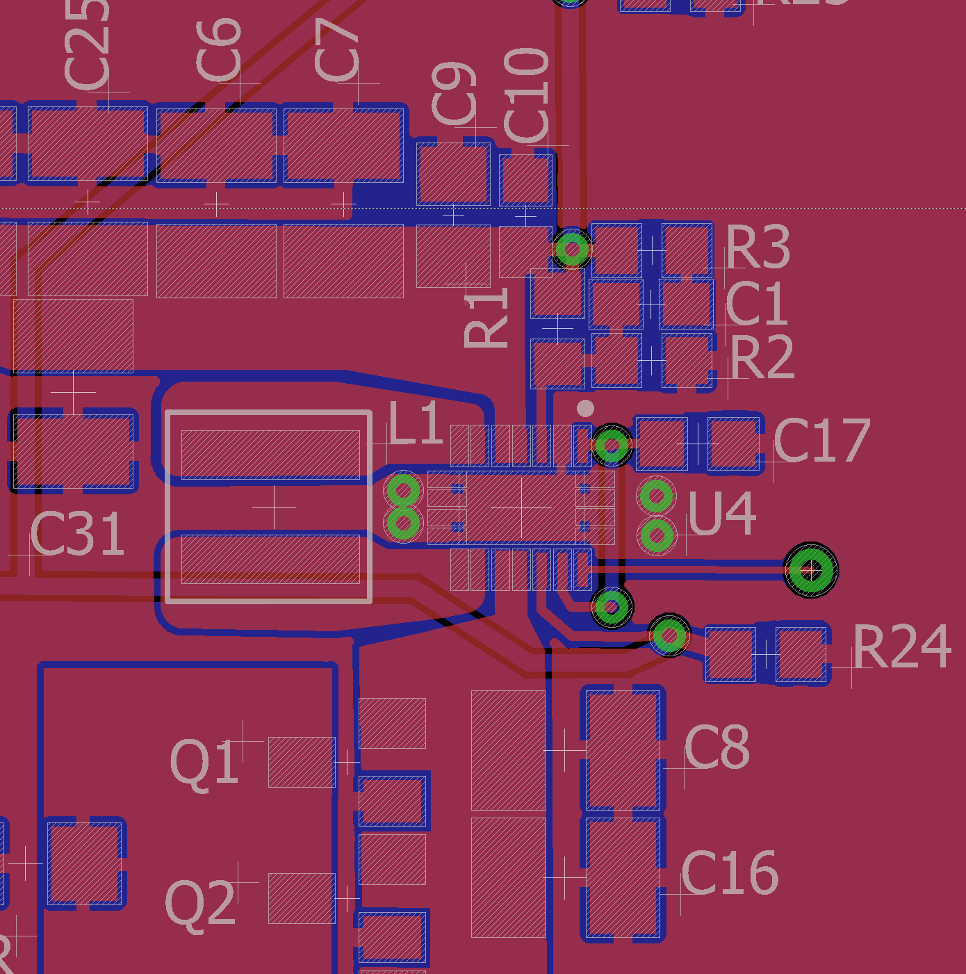

I've had 3 TPS63020 parts running for several weeks in my prototypes without any problems.
First 10 boards of new production some are failing.  Some run for hours other fail immediately.
Defective device L2 pin can be measured as almost 0 Ohm to GND.
Input Voltage is 3.3V to 5.5Volts
Output 5.4 Volts Load 1.5 Amps.
PCB layout is almost identical to EVM pcb.
Production code on original chips are different to the 10 with failures they all have the same production code.
Is there a known issue with TPS63020 ?
  • Hello H,
    Could you please tell me if there are any other differences between your design(s) and the EVM? What kind of inductor is used? Do you have load transients?
    In the meantime I can try running the EVM under the same conditions.
    Milos
  •  L1 = Coil Craft  XFL4020-102MEC
    Output Caps: C6,7,25,31 are 22uF 10V X7R C9=1uF 25V X7R, C10=10nF 50V NOP
    Input Caps: C8 C16 are 22uF 10V X7R
    R1=1M
    R2=100K  for Vout for 5.4V
    Pin PS/SYNC is tied to VINA which is decoupled with 100nF X7R 25V
    Enable Pin is pulled down to GND by 100K and enabled by Microcontroller with 3.3Volts.
    Your comments are welcome.
  • Hello H,
    Thank you for the layout. The connections look fine, however I have a few remarks:
     - The output capacitors should be placed closer to the device, ground ends especially. If that is not possible, at least ground vias should be used to improve the connection between GND ends of the I/O capacitors and the device GND.
    - Thermal vias should be added under the exposed pad to prevent from thermal protection limiting the output current.

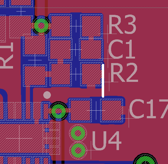

    - It is not a good idea to share a ground path between the power part and the control (feedback) part. You can brake this by cutting the GND layer here:
    I ran the EVM under the same conditions and did not experience any problems. For the  start let's try a few things:
     - Do you have load transients, and if so, could you show scope measurements of the I/O voltage when the output current change, and during startup?
     - Can you try running the circuit at lower output currents?
     - Do you still have some devices from the previous batch that you could try?
    Milos

    Point taken about the FB GND... Thanks
