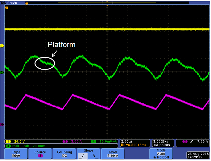

When using LM5145 EVM, its output ripple has a platform, which is pretty weird, and it also exists in LM5141. Therefore my question is what is the cause of this platform?
Green line is output ripple, in which ripple caused by ESL, ESR and C itself can be clearly seen;
Yellow line is VIN;
Purple line is Inductor Current;
Thank you very much!

  • Wenhao,
    My best guess would be some resonance in the circuit due to component selection and/or layout. We see a very stable inductor current waveform so the FETs are behaving properly. And the IC doesn't have any other capability to change the output voltage, especially at a frequency ~2x Fsw.
    You could do some tests to confirm. You can add/remove different types of output caps in different places. You could change the frequency of the controller. You could try a different inductor.
    -Sam
