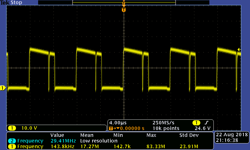

My customer uses the LM5140-Q1 in a 24V -> 12V application and observed a strange waveform at the switching node.
Do you know what the cause might be? I will send you the schematic via email.

    This looks like subharmonic oscillation. This is common in current-mode converters/controllers at duty cycles above 50%. Check the compensation in WEBENCH to make sure this is compensated properly.
    Please also check the small pulse off-time. I want to make sure it's >45ns (Ton_min) so we know the IC is not faulting.
