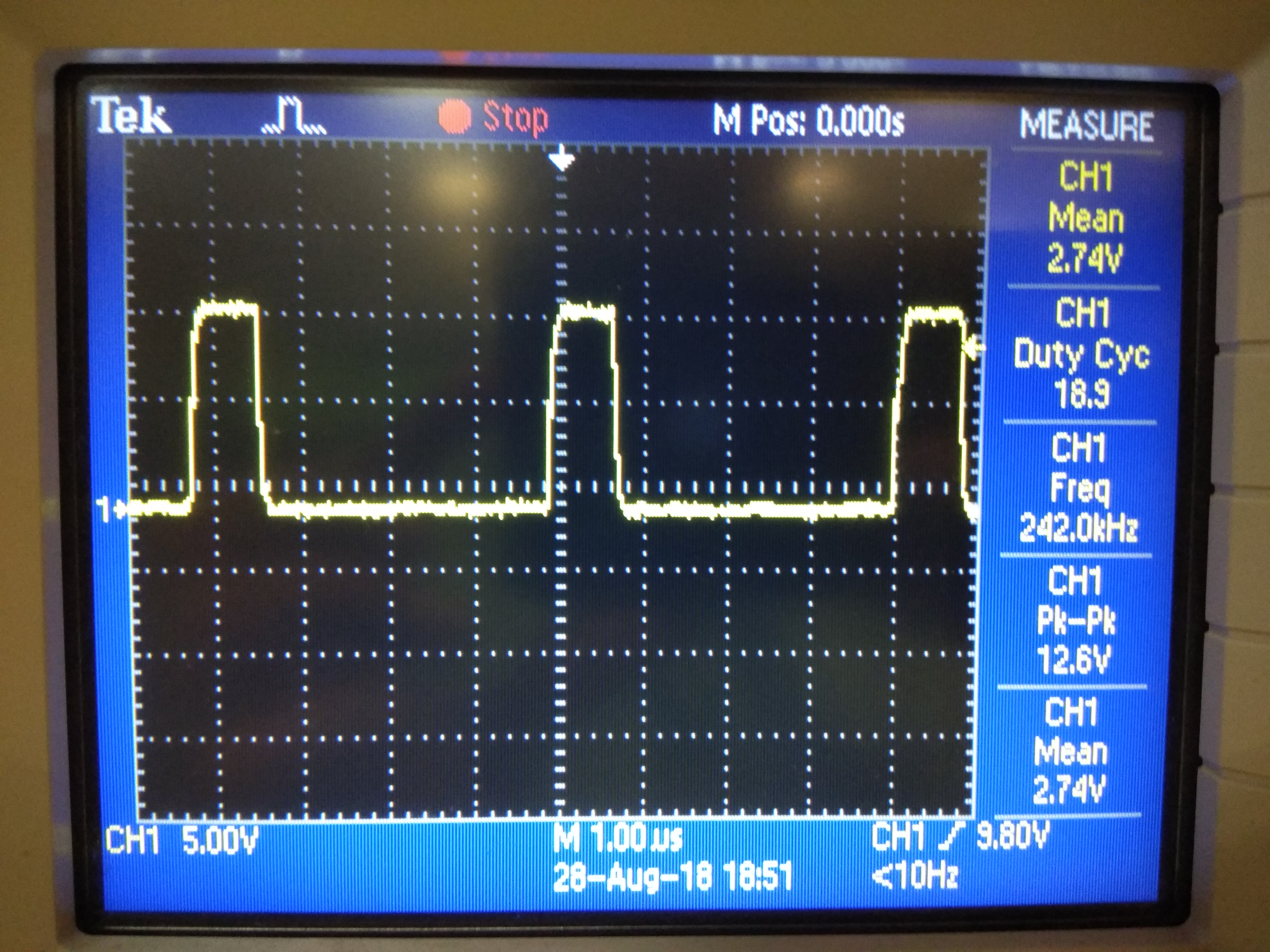

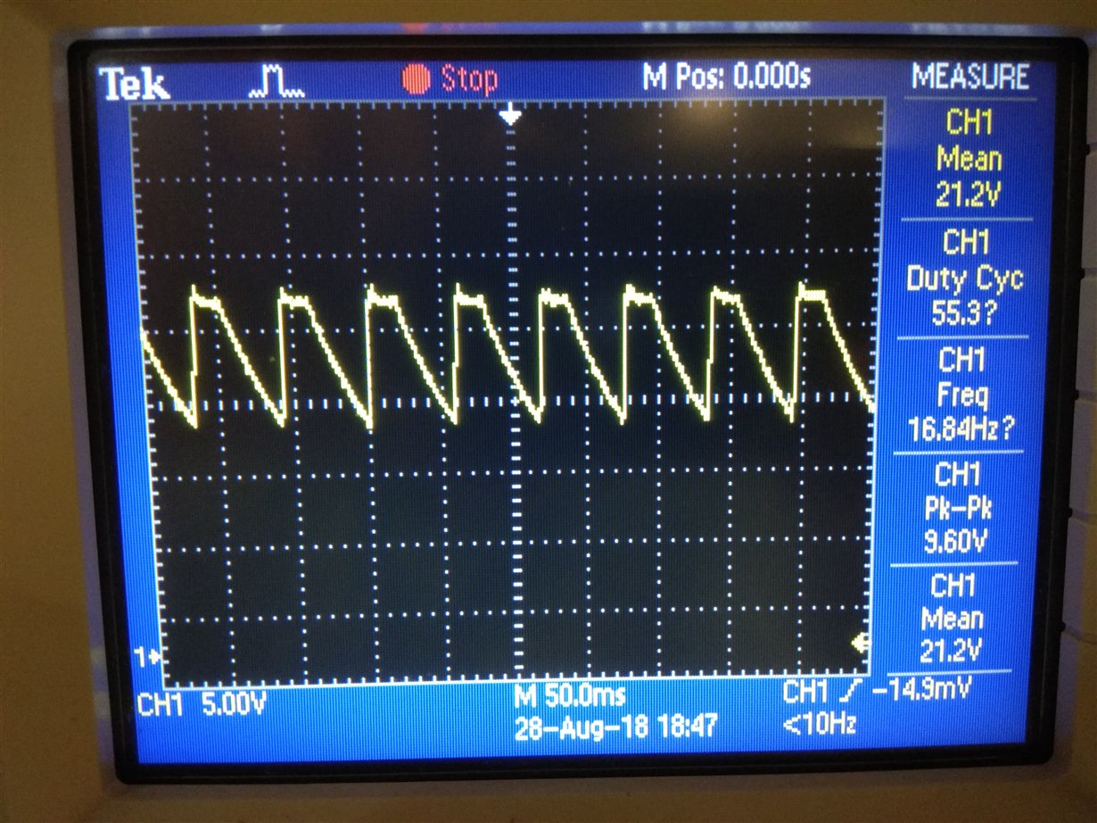

     As per your suggestion, we changed the Optocoupler to the recommended CTR. According to the design we are supposed to get 24VDC but we are getting around 21V with large voltage spikes. The image of the output voltage is attached for your reference. This is without connecting any load at the output of the PD circuit. Can you suggest us a solution for this issue. Also attached are the Gate pulse waveform

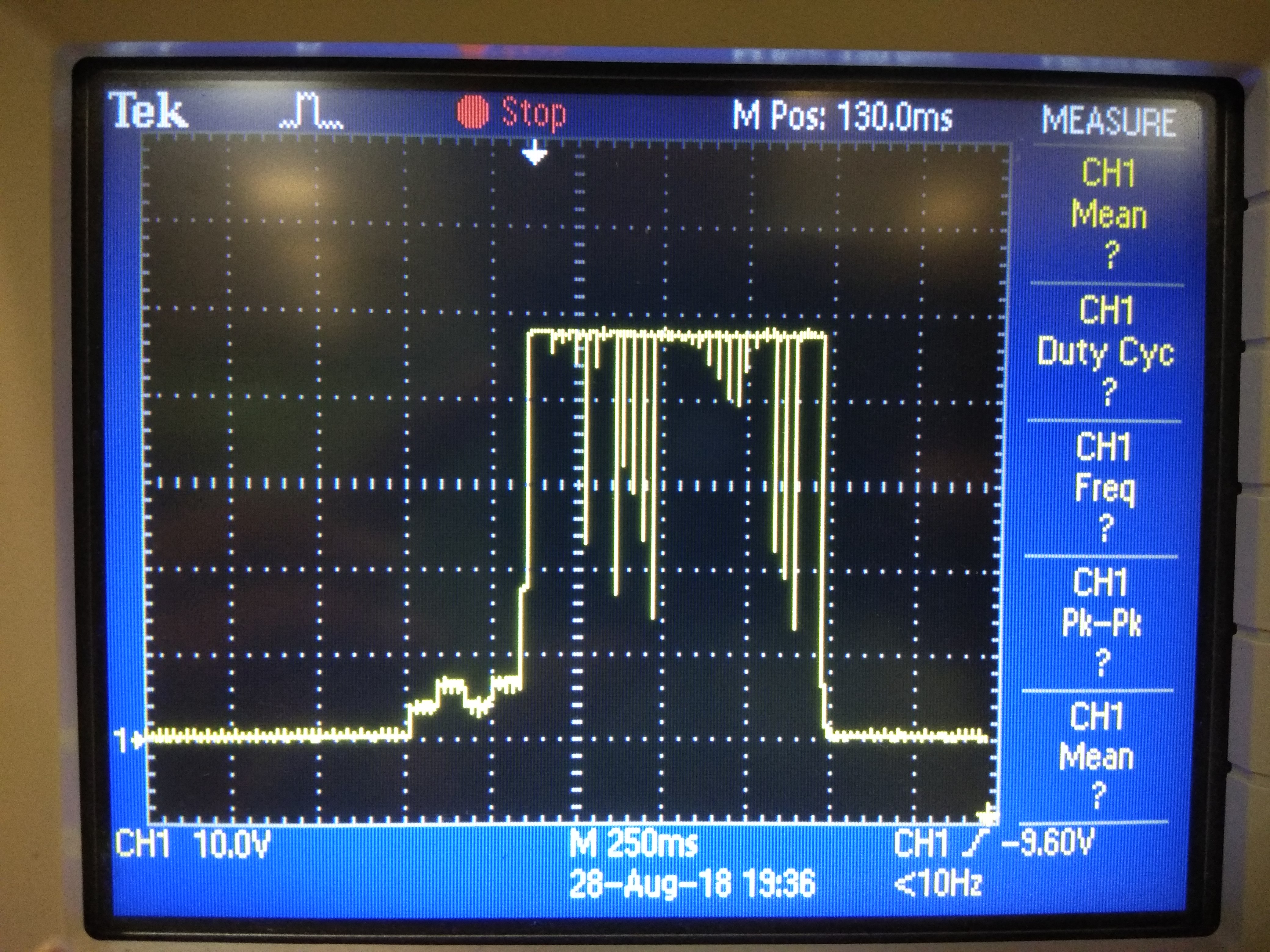

After connecting with the rest of the circuit which will take around 200mA max. The ouput was fluctuating, so we had a check on the supply from the PSE (we were using TPS23861EVM) and we found the 48VDC was not constant. The detection was happening and 48V is supplied but after around 800ms falls to 0V and again the cycle repeats. Attached is the waveform for your reference. Also attached is the waveform measured at VC in this scenario.
Can you please look into this and suggest us the solution.
