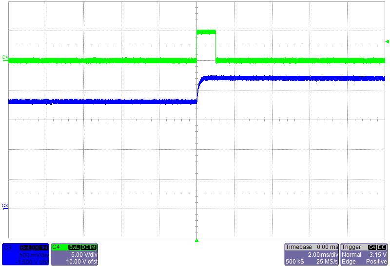

    What do you mean by power on?  Is that Vin or EN toggling?  Can you post a waveform, with the SW node?
    Here is the EVM's behavior when VSEL3 is toggled at 1 Hz with VSEL4 floating.  VSEL1/2 are low, so Vout should be 1.8V.  Green is VSEL3 and blue is Vout.
    I don't see Vout go up to 3V, as it would with both VSEL3/4 high.  After VSEL3 goes low again, Vout still stays high as the IC does not sink a voltage.

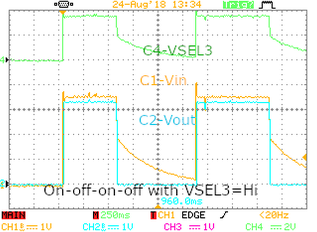

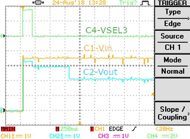

  • Power-up sequences
    - turn on Vin, EN = Vin,
    -  All control lines that are at Hi state are tied to Vin.
    Here's a scope shot, kind of nasty resolution, but it's no R&S or Tek scope ;-)
    it's 'cold start' condition, Vin at 0, going to 3.6 V (i think)
    VSEL3 is tied to Vin to start with, then disconnected and reconnected to GND (by hand, as fast as possible... did not have any SPDT switches close to hand ...
    VSEL3 is loaded by the scope probe, 1 M, 12 pF. Which does, as I saw in other tests, affect the VSEL3 change of state when it's otherwise 'floating'
    Anyway, here, one can see that Vout is high, to begin with, and then drops a bit when VSEL3 changes to Low, and a bit later, about 600 ms, Vout shows that VSEL4 has made it to the low state.
    now a couple of other scope images, two cold-starts, in a row, with VSEL3=GND in one case, VSEL3=Vin in the other case, showing that VSEL4 does seem to 'follow' VSEL3 at cold start (but, not forever ;-) ) This shows that Vout is consistent with VSEL4 initially at the same 'state' as VSEL3...
  • Thanks. So all these tests were on the EVM with VSEL4 floating?
    In the second waveform, Vout goes to 3.3V which indicates that both VSEL3/4 are high.
    In the last waveform, Vout starts at 3.3V (both VSEL3/4 = high), then goes to 2.9V (VSEL3 = low, VSEL4 = high), then goes to 2.1V (both VSEL3/4 = low).
    In the second and third waveforms, is VSEL3 changing by hand? I used a function generator in my setup but otherwise, they should be the same.

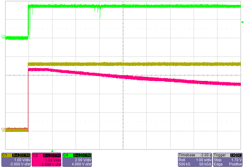

  • I do see similar results, but only when I power up Vin.  Toggling VSEL3 during operation did not seem to couple to VSEL4.
    Same setup as your scope.  Green is VSEL3, yellow is Vin, red is Vout.  Vout first goes to 3.3V, before dying down to 2.5V.
