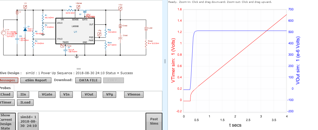

I have simulated the module by using texas webench designer , can you explain the simulated graph. I am confused about that.

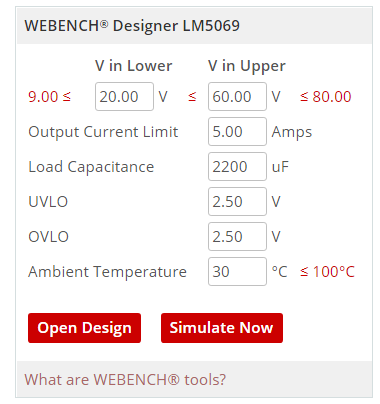

- And what is the output current limit in webench tool.
- My output will be max of about 30amp but in output current limit option (under webench tools) doesn't increasing above 10amp.
- Does the output current limit option means the current requires for the capacitive load to charge.
- Even the mosfet used in the circuit was 100V and 30amp, which is not suitable for my appln.
Correct me friend if i am wrong.

Parameters:
- Mosfet nce7580 (http://www.dzsc.com/uploadfile/company/332784/201081617837365.pdf)
- Vmin= 20v
- Vmax= 60v
- soft start method (slowly increasing the gate voltage of mosfet to reduce inrush current)
- load 2200uF
- Output current of mosfet will be above 30amp
