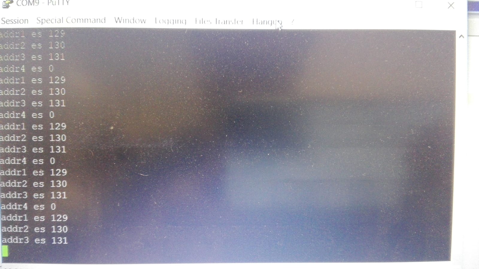

Then I tried to assign and read the address register of each one, but when I reached the third device the address was 255. As it's a wrong addres, I reset every device and start again but when this event takes place, after assigning the first address I also read 255 from the first one. (Picture below)
When I unplug the second connector, leaving the forth and fifth devices unpowered, I'm able to assign the third address. The program resets the devices when it reads that the forth address isn't right:
