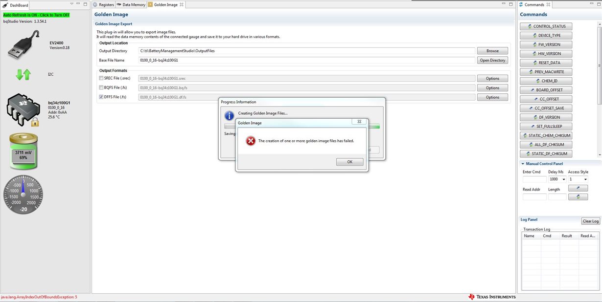

  • It won't let me create either the .df.fs file or the .bq.fs file. Only the .srec file is available. I'm getting the error attached.
  • Hi Eric,
    If you leave all three check-boxes checked, does it work?
  • It still gives me the same error. The srec file is created, but the other two fail to be created.
  • We just tested bq34z100-G1 with bqStudio version 1.3.86 and it can export the Flashstream files okay. Can you please update your bqStudio, make sure the gauge is unsealed (no lock icon on the left side), and try again?

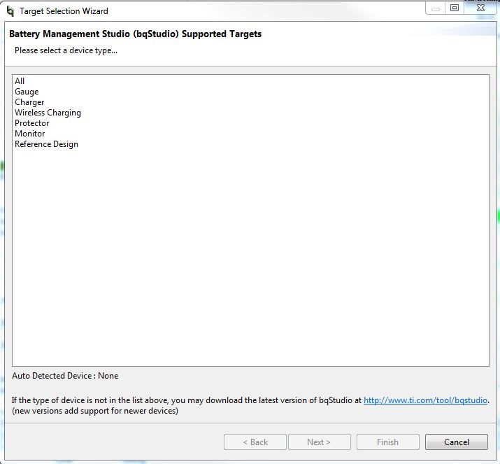

  • For some reason, my bqStudio is not able to communicate at all with the fuel gauge now. I don't know what happened. I am looking into that to see if I can figure it out.
  • Hi Eric,
    When you launch bqStudio and no gauge is autodetected then a window pops up with a list of gauges you can select. At the bottom of that window it shows what gauge and FW version were autodetected. Is there anything listed there? Maybe you could send a screenshot of that view, then manually select bq34z100-G1 and send a screenshot of the next screen, too.
  • Nothing is listed at the bottom. It is not detecting anything. Attached are my two screenshots.
