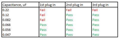

 This is regarding TPS2384 detection problem with Si3402 at room temperature. I found few threads in forum with similar issue.
TPS2384 fail to detect SI3402BISO-EVB module if the port capacitance is 0.22uF. I tried to reduce the capacitance and tested it again.
I found that the rise time of detection pulse will directly impact the detection of SI3402. It seem like the rise time need to be longer than 2.6 ms in order to detect SI3402.
Can I know what happened to TPS2384 that cause this issue and what is the recommended capacitance value to solve it?

  • Hi Joseph,
    The port capacitance of TPS2384 should be 220 nF – 470 nF. When you varies the port capacitance, did you change the port capacitance on the PSE side or PD side? TPS2384 requires minimum 220nF to ensure system stability. Thanks.
    Penny
  • Hi Penny,
    I changed the port capacitance on PSE side. So, I should increase the port capacitance instead of decreasing. Do you have a specific capacitance value that will work with Si3402 evaluation module? Since this detection issue is a known issue , do you have recommended solution to solve it?

  • Hi Joseph,
    For the other TPS2384 detection issue, it only happens at high temperature on the customer side, however, we din't reproduce the issue on our bench. TPS2384EVM just worked fine with our customer's IP camera with SI3402 inside. What's your port cap on the PD side? Thanks.
    Penny
