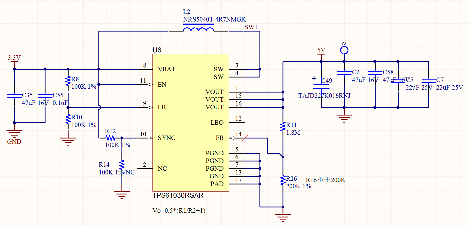

Hi team,
Our customer Benewake is using TPS61030 in their project. But for now they get one problem under low temperature operation. Below is their circuit and the output load is no more higher than 2A.
Under the normal temperature operation, the system is OK. But under -20C test, system is abnormal. And customer did the cross experiment. They connect the 5V with external power supply, and the system work normal. So we think it's because of the abnormal of 5V power supply.
Could you give some comments to this?
