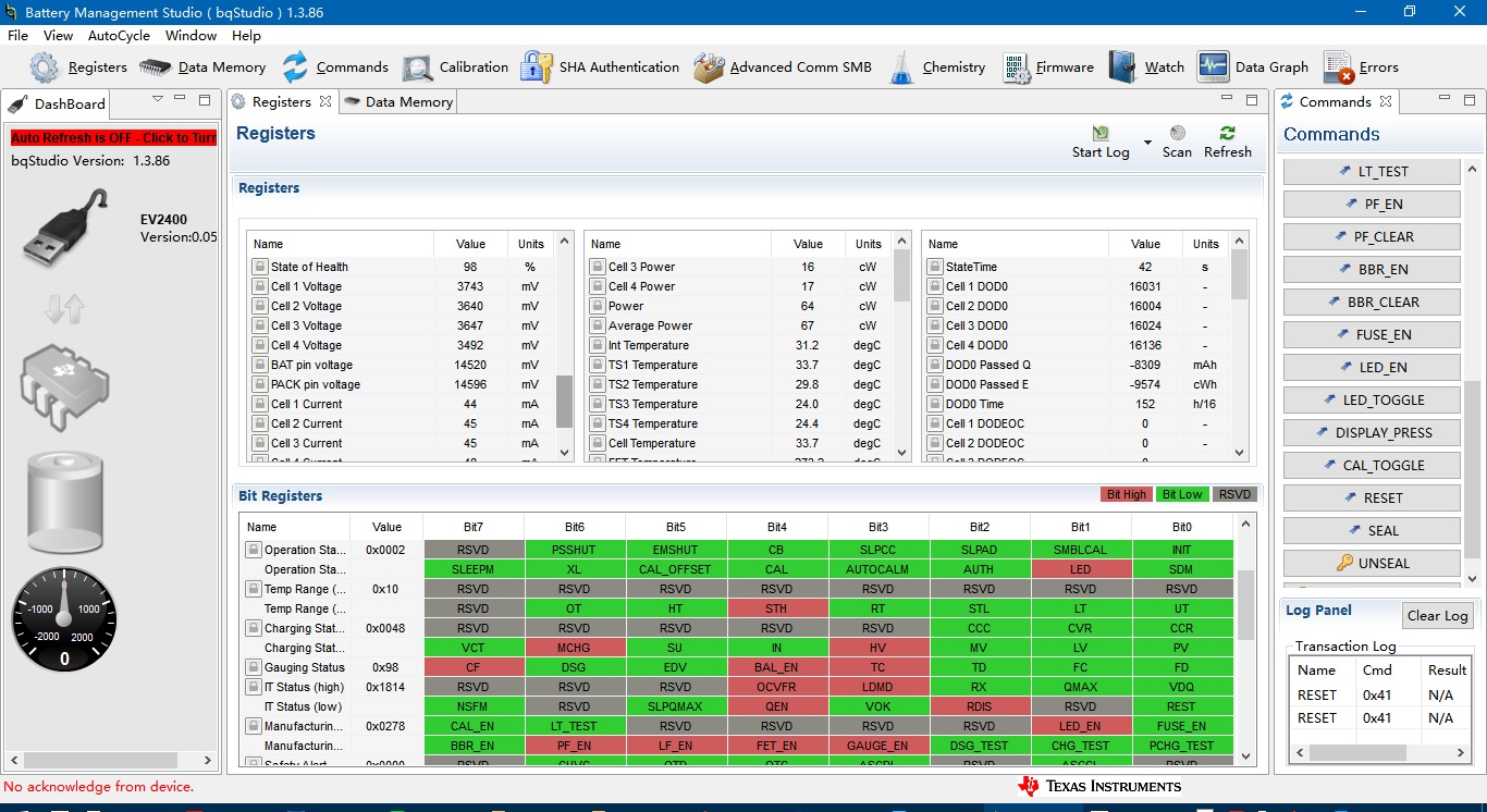

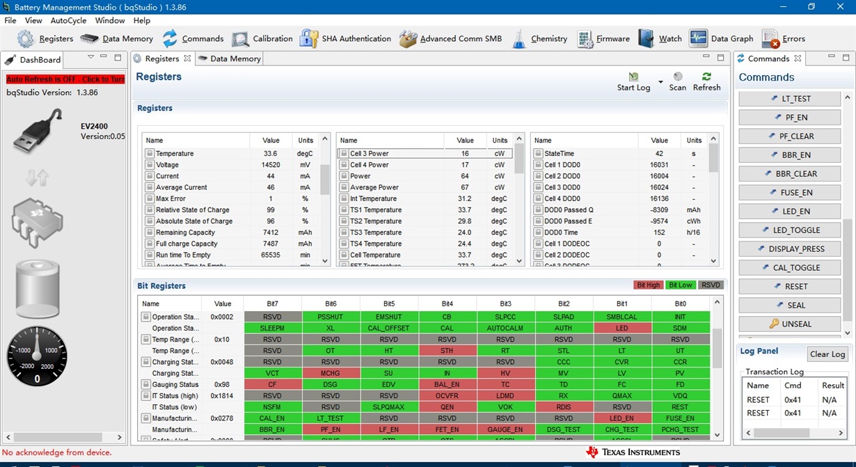

BQ40Z50-R1: Why Valid Charge Termination Condition has met,but the VCT and FC not set 1.
Part Number: BQ40Z50-R1
Dear All:
I use BQ40z50-R1 design 4S2P LiFePO4 battery pack. the Capacity is 7800mAh.
this is gg.csv file:BQ40z50-R1.gg.zip the ChemID is 0438.I set the charge Term Taper Current is 100mA and Charge Term Voltage is 250mV,plug in 14.6V adapter Between Pack+ and Pack-.when the AverageCurrent is 46mA and the Maxcellvoltage1..4+Charge Term Voltage is 3993mV>3650mV.the screenshot as follows
Why Valid Charge Termination Condition has met,but the VCT and FC not set 1?
