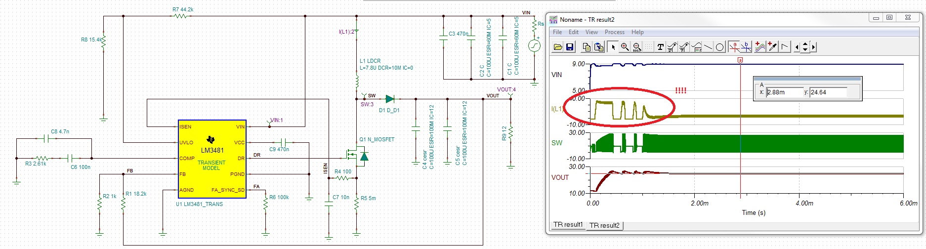

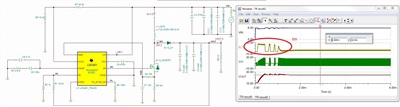

My customer is finding a boost, below are the basic requirements for this:
1. Input voltage: 6~12v
2. Output voltage: 24v
3. Output power: 24W normally, 48W max;
4. Switching frequency around 200kHz for EMI consideration and thermal consideration;
It seem LM3481 is a good choice, however, with Webench, it seems the simulation result is not correct at all. So would you pls help give a reference schematic to realize above condition. For the inductor, customer has 6.8uH(14A), can expert help provide other components value based on these conditions(Especially the slope, Comp and Rsense, Csense)? Thanks a lot.
