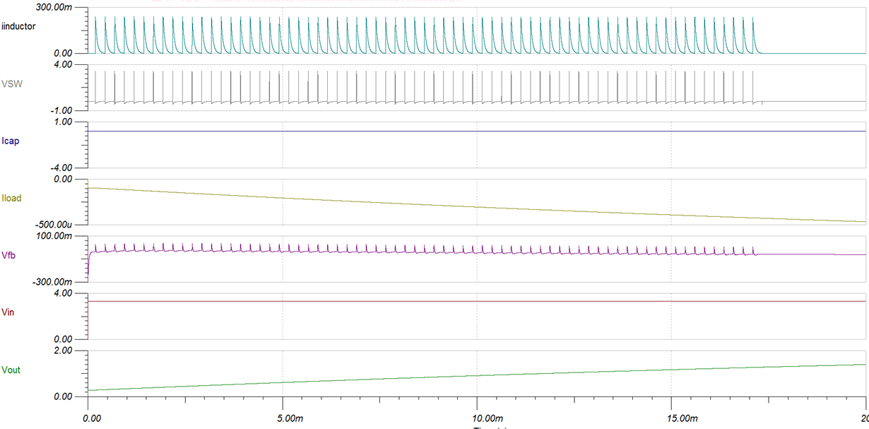

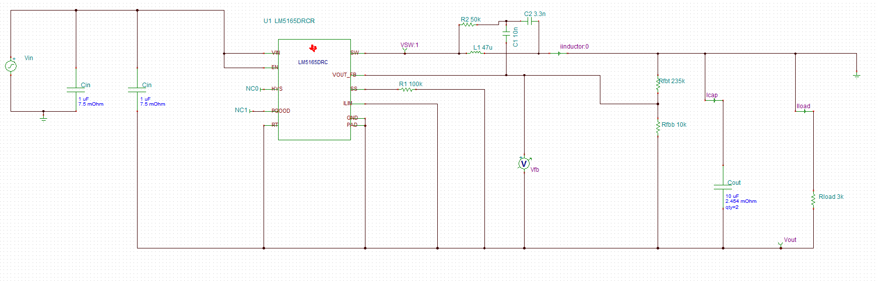

I am trying to use the LM5165 as an inverting buck because of it's wide voltage range and very low Iq.
Vin=3.3V, Vout=-30V, Load=<10mA, PFM mode.

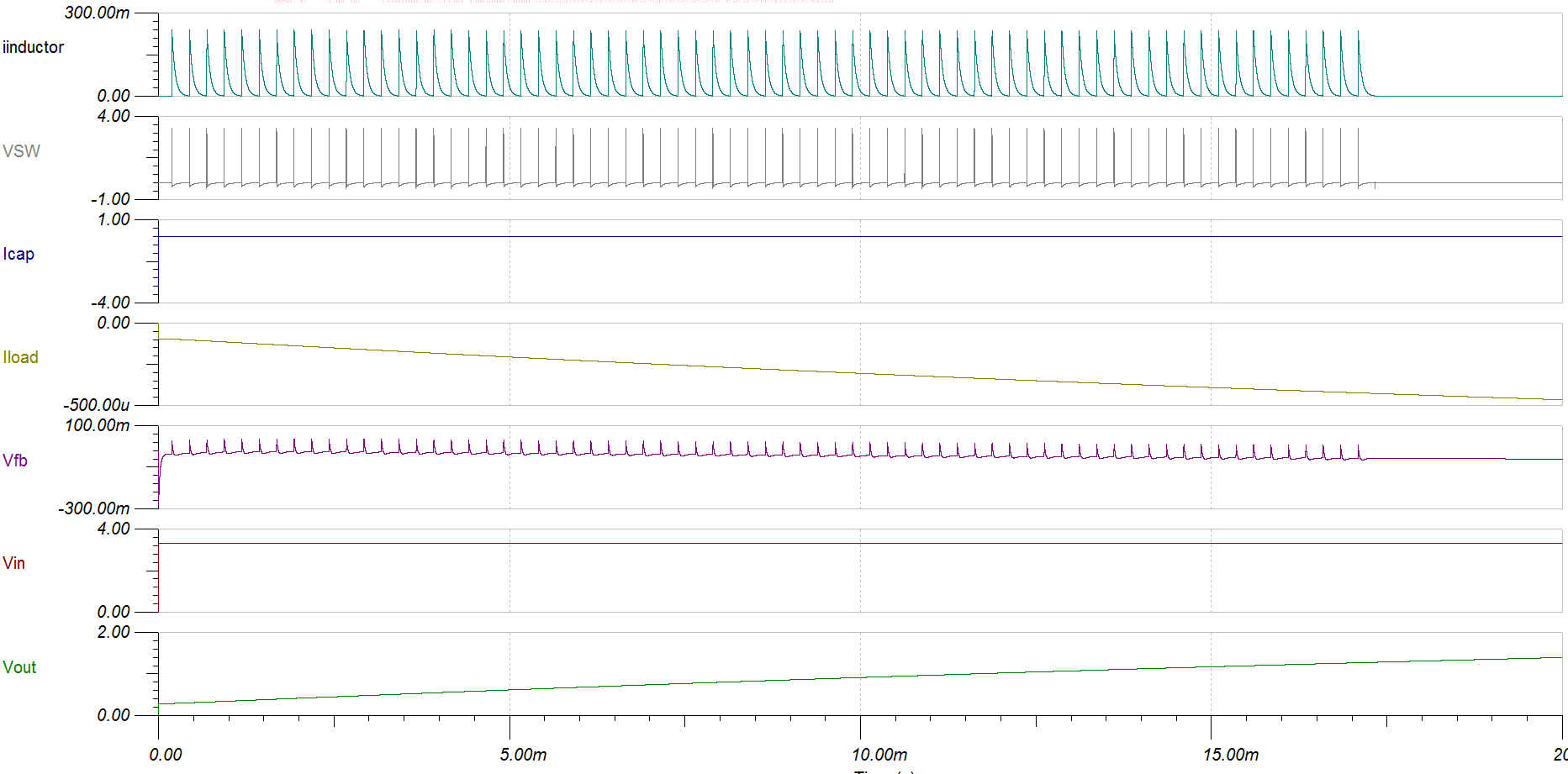

When simulating this circuit, the device begins switching and the output voltage starts to ramp. However, the device then stops switching and the waveforms behave strangely afterwards.
I'm assuming there are some dumb errors in my schematic? Does COT buck work for inverting applications?
 1423.circuit.TSC

    I think your schematic is fine, it's just the model which can't handle the topology. We have models for some parts that specifically say they can do buck AND inverting buck-boost. This one looks like it's just set up to do buck.
    Let me double check if this is the case for this one as well as why this is the case. I'll get back to you in a bit.
    -Sam
  • Ryan,
    Well if I had searched E2E I could have saved me 20 minutes looking at your schematic. Haha. This is a common issue and I was correct in my previous post. Models which are not designed to allow inverting supplies often have hard GND connections. So the GND symbol outside the IC will connect to the GND pin in the IC regardless of whatever else is connected to that pin.
    We do have models for some parts where the GND pin of the sim IC is floating but unfortunately this is not the case for your part.
    Your best bet would be to get an EVM and modify it as necessary. You could also try posting to the modeling E2E forum.
