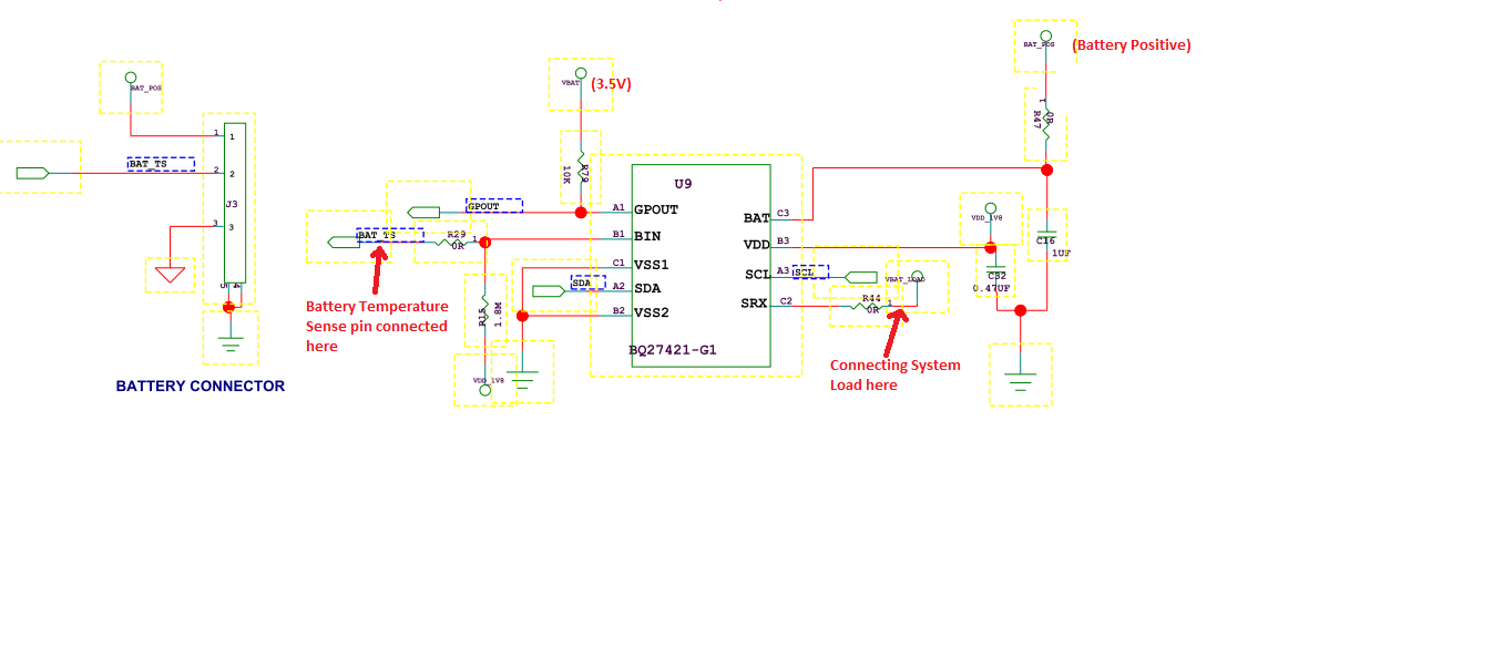

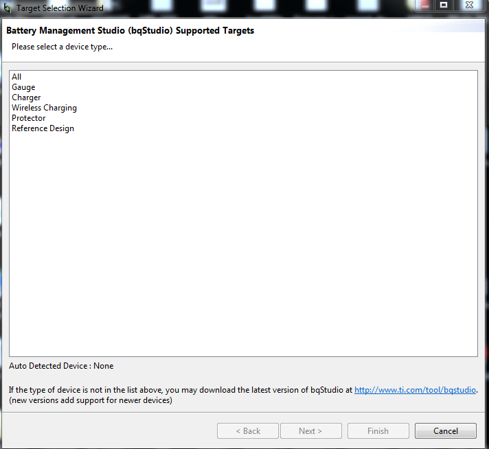

I have connected BQ27421-G1 with BQStudio using EV2400. When I click on BQStudio GUI icon, I'm getting a pop-up asking me to select the device. Even if I select Fuel Gauge & BQ27421-G1, I'm not getting any acknowledgement from the device.
I have used pull-up resistors inside EV2400 for SCL & SDA lines.
I got battery voltage 3.8V at BAT pin & fuel gauge generated 1.8V at its VDD pin. This confirms that fuel gauge is working properly.
I'm using BQStudio v1.3.54.1 & EV2400 v0.18.
I'm not using EVM. I'm working on our design which uses BQ27421-G1 for measuring battery SOC.
