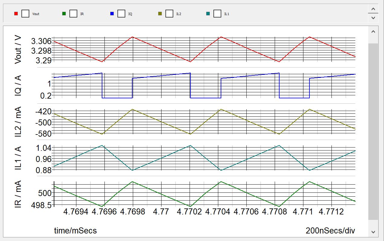

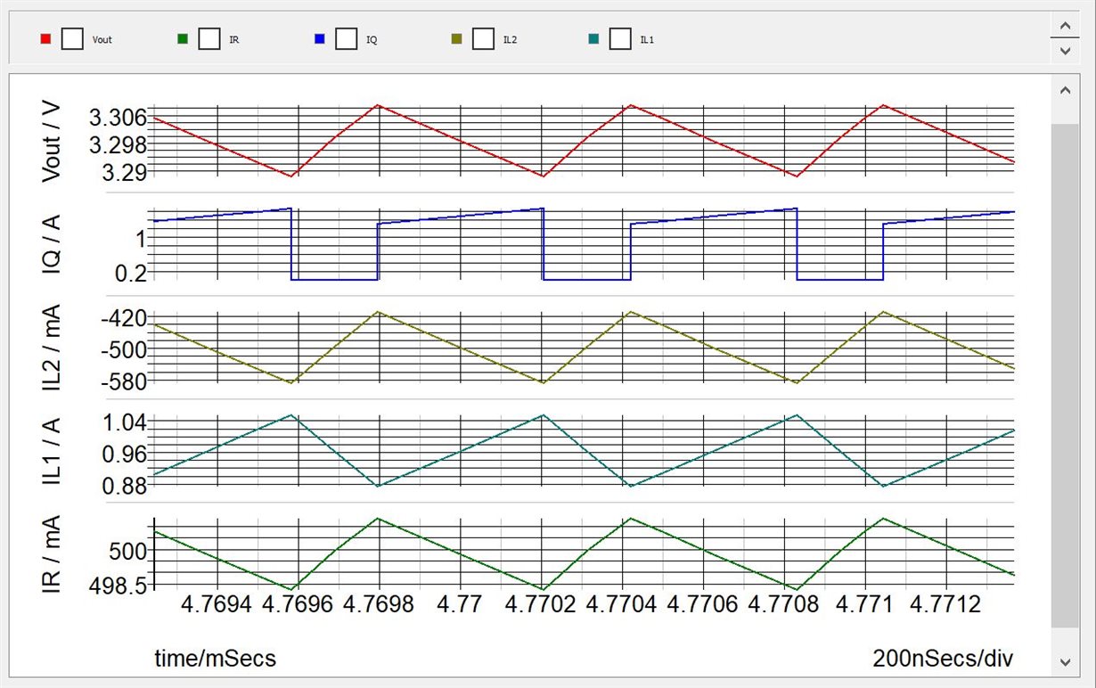

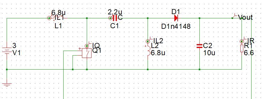

  • Hi Julien,
     1 You can't use this equation: On page 16 ILpk = Iout / D' (if we neglect ripple)
     because this is for boost topology not SEPIC.
     2 If we neglect, MOS peak current is about Iin+Iout.
     I simulate it by SIMPLIS
     Test conditon:
      Vin=3V Vout=3.3V Iout=500mA,
      By the waveform, switching peak current is about 1.64A(blue IQ line) (this is no take loss into consideration).
      If I change Iout=1A, switching peak current is about 3.96A
    Iout=1A
