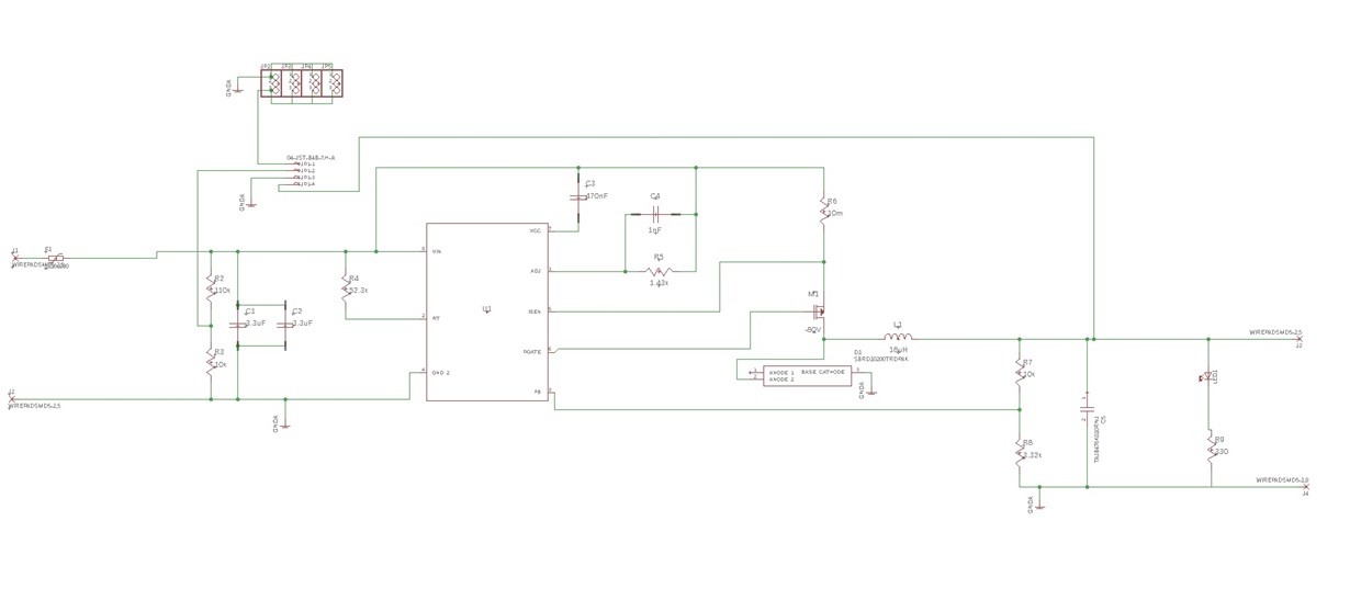

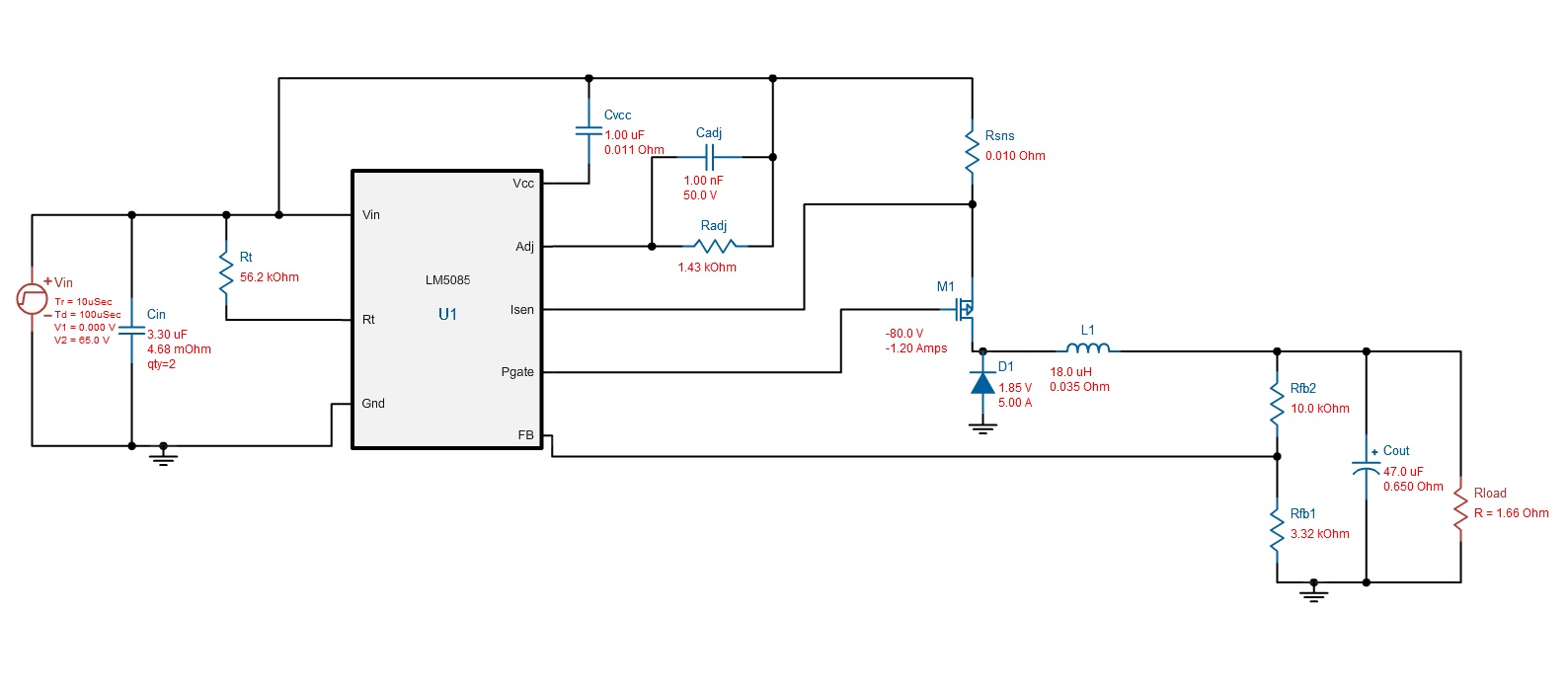

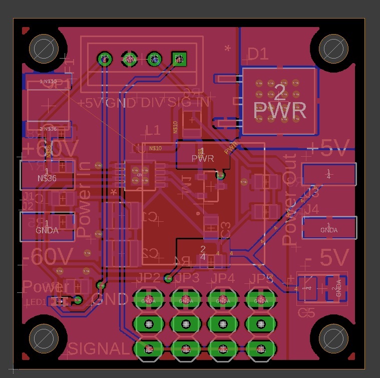

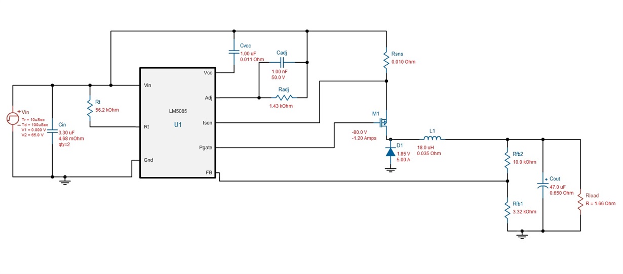

I designed the following circuit using Webench its a 60VDC to 5VDC buck converter and I'm looking to run it with about a 1A to 1.5A load, I built a prototype of the board using the suggested components (SQ2337ES P-ch Mosfet), but I am having an issues with voltages over 20V, originally I assumes that the LM5085 Pgate pin was regulated, but it seems to measure a voltage that is just under the Vin voltage, so in this case when I exceed the 20V gate limit the circuit shuts off. Any suggestions on how to resolve this issue, would I need to add a voltage divider, is there a better way to limit the max voltage seen at the gate of the P-ch Mosfet? I would realyy appreciate any help or advise. Thank you
