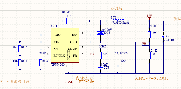

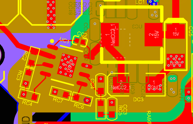

My problem is that if the 15V output is unloaded, 15V is stable. If the 15V output has a 50mA load, the voltage is pulled to about 3V.Why?
Kailin,
1. Is the switch node stable? It should be a constant rectangular wave.
2. Did you follow the layout guidelines in the EVM and datasheet? Please share the layout.
3. Is the IC getting very hot?
-Sam
Kailin,
You will need to redo your layout on your PCB. Follow the layout guidelines on the datasheet. You can also look at the EVM for general layout.
