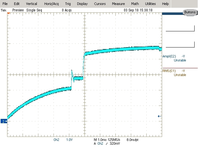

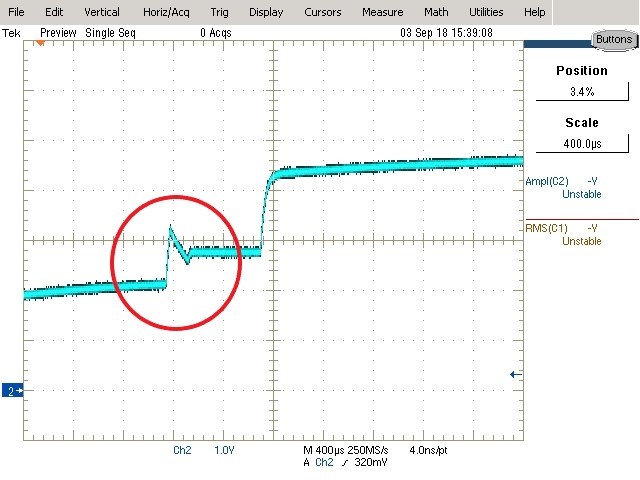

Hi team,
When I tested the TPS548D22EVM-784, I found that the voltage overshoot occurred as shown in the BP pin before reaching 2.93V.In general, LDOs do not have this problem. Please explain the reason for this voltage overshoot.
Thank you!

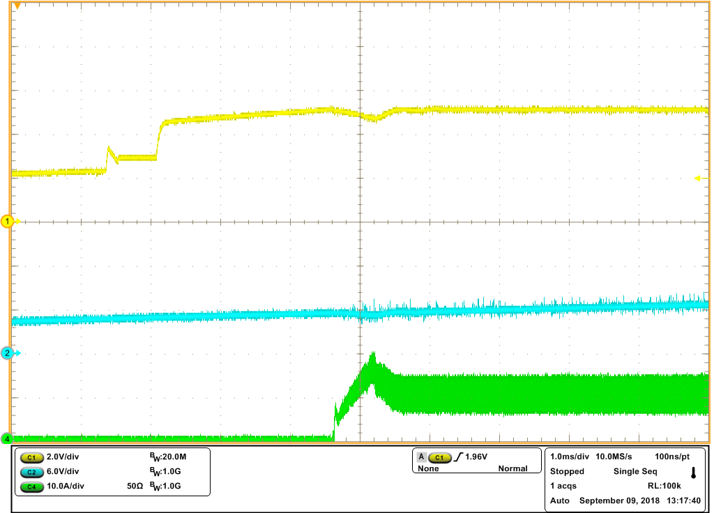

Hi Amnat,
In order to observe the influence of the input voltage source on the LDO output, I also detected the input voltage and the BP pin and found that there is no voltage overshoot on the input voltage source. In the figure, channel 1 is the LDO output, the BP pin, and channel 2 is the input voltage.I think the influence of the input voltage source can be eliminated. Do you think there are other factors that influence it? Or is this method wrong?
