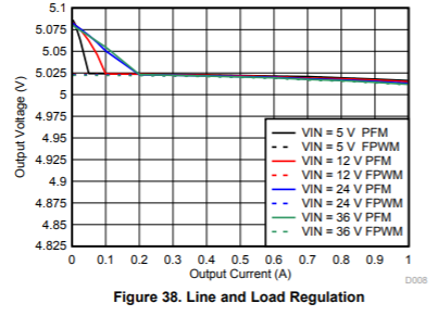

LMZM23601V3SILR output regulation at FPWM mode is +/- 1.5%, right?
Can this vary at PFM mode?

The "Line and Load Regulation" figure in the datasheet can help illustrate the output regulation between FPWM and PFM. For example if your application is Vout = 5V, you can look at Figure 38, this figure shows how the output voltage will deviate with increasing load. In any case, the voltage regulation for both will be no more than +/- 1.5 based on the Vfb accuracy.
