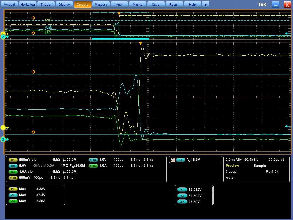

1. DIAG  issue :
For 60W LED device can be normal work on DIAG pin on each channel.
But 12W LED device not all channel can be normal work on DIAG pin.
In lighting control board this project. Customer software team found DIAG pin no signal on some channel as attached waveform.
They removed 0 Ohm from DIAG pin to MCU’s connect. And mark the PWM duty & channel as file name.
Please help to check what happen. And what can we do?

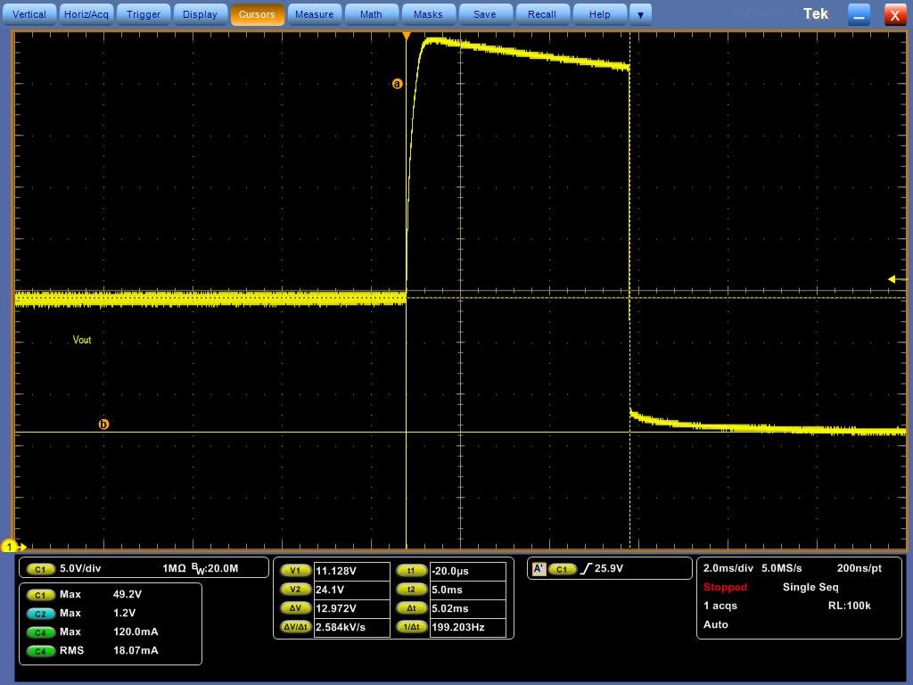

2. Plug issue :
When customer remove & plug the LED device(2.5A) sometimes no output at channel 3.
After check it always happen on PWM duty 90%~100%. And they will try to remove & plug the LED device(2.5A) on this moment.
Does it about OVP or others protection? Waveform are below.

  • Hi Patrick,
    Sorry but the description is not that clear to me. Could you please clarify a little more?
    1. Diag issue
    What is the waveform that you think DIAG is abnormal? I do not see this waveform.
    2. Plug issue
    What do you mean by channel 3, since this device should have only 2 channels outputs?
    What is the waveform on DIAG pin when this happens? It's better to look at the waveform of DIAG to see what fault is triggered.

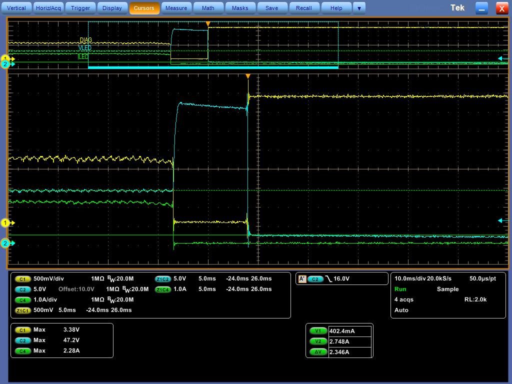

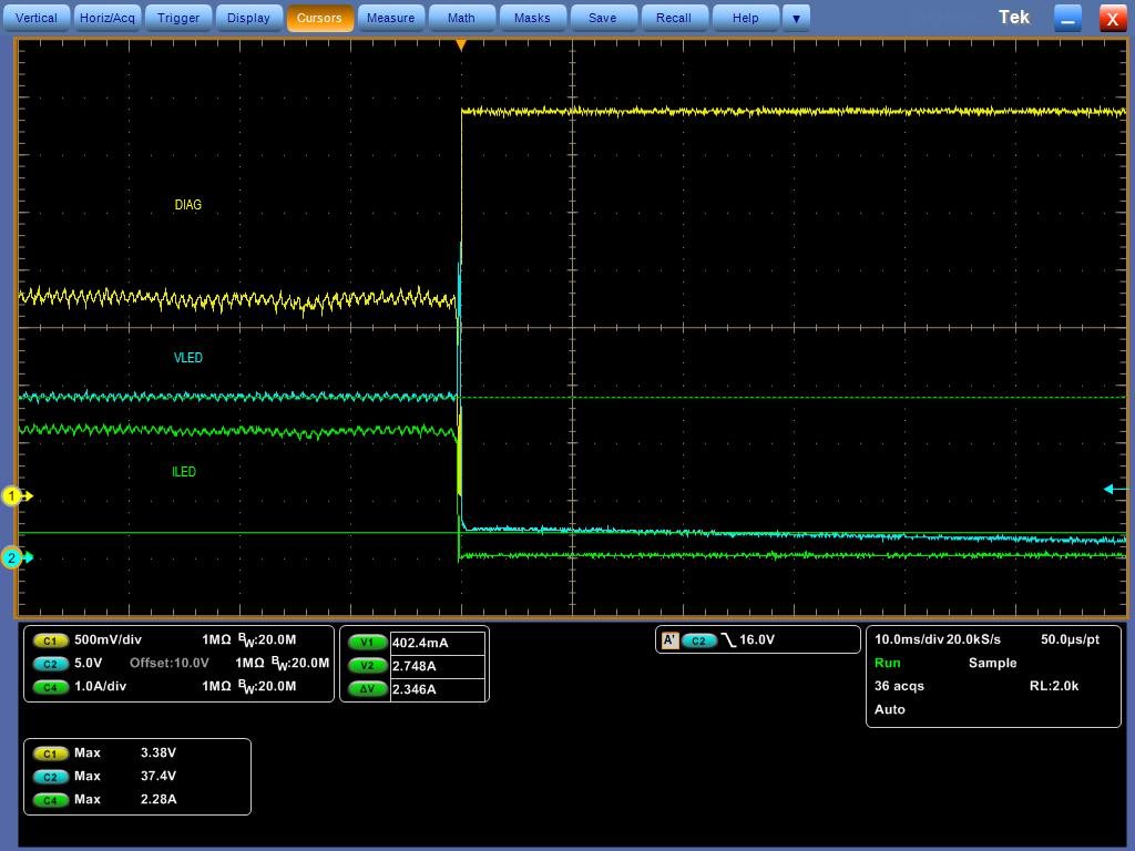

    2. Plug issue
    Ans:
    After check each channel may happen. And also attached the DIAG waveform when this happen.
    remove abnormal
    remove abnormal2
    remove abnormal3
    remove abnormal4

  • Hi Patrick,
    1. Diag issue
    What is the required output current of channel 1-4? When you say channel1-3 are abnormal, are their output current normal?
    1. Plug issue
    According to the waveform of DIAG pin which is above 3V, overcurrent protection is triggered. Why does customer need to remove and then plug the LED in such a short time?
    Sorry for keeping asking questions, because it's still not easy to figure out what happened based on the information you provided. Besides that, the schematic is so unclear. Would you mind inserting a clear one? Thanks.
