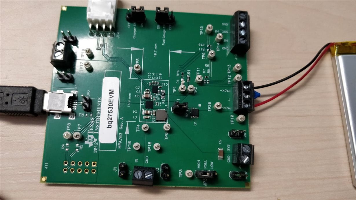

Hey
I'm using the BQ27530EVM board along with the EV2400, bqstudio(1.3.54.1) and a 1400mAh battery.
I have tried to power it from both the USB port and from the J2 input with a 5V 3A power supply, both fuel gauge and charger is enabled on the board but the battery doesn't get charged.
The Bit registers is currently as seen in the picture:
I also seen to can't find the "learning cycle" tab?

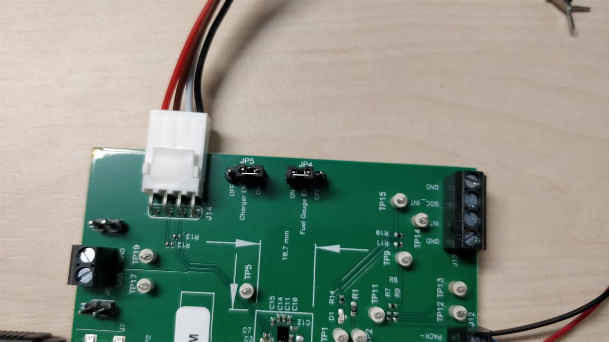

  • Do you have a athermistor connected/? Do you have jumper in the correct places for jp4 and jp5?
    thanks
    Onyx
  • I had athermistor connected along with the temperature input from my battery, I have now disconnected the athermistor and the temperatur dropped to a more reasonable 25.25 deg celsiuc. It still doesn't seam to want to charge with more than 90 mA from the USB input. both the JP4 and JP5 jumper is set to ON.

  • pls attach a bqstudio log. is this test being run on an evm or your board? If using the EVM, how do you have jp3 connected? pins 2-3 or pins 1-2? Can you send a snap shot of your EVM setup if you are using one?
    thanks
    Onyx

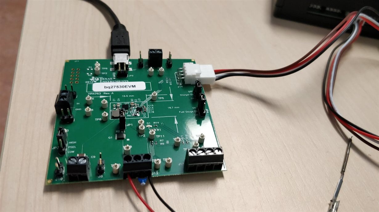

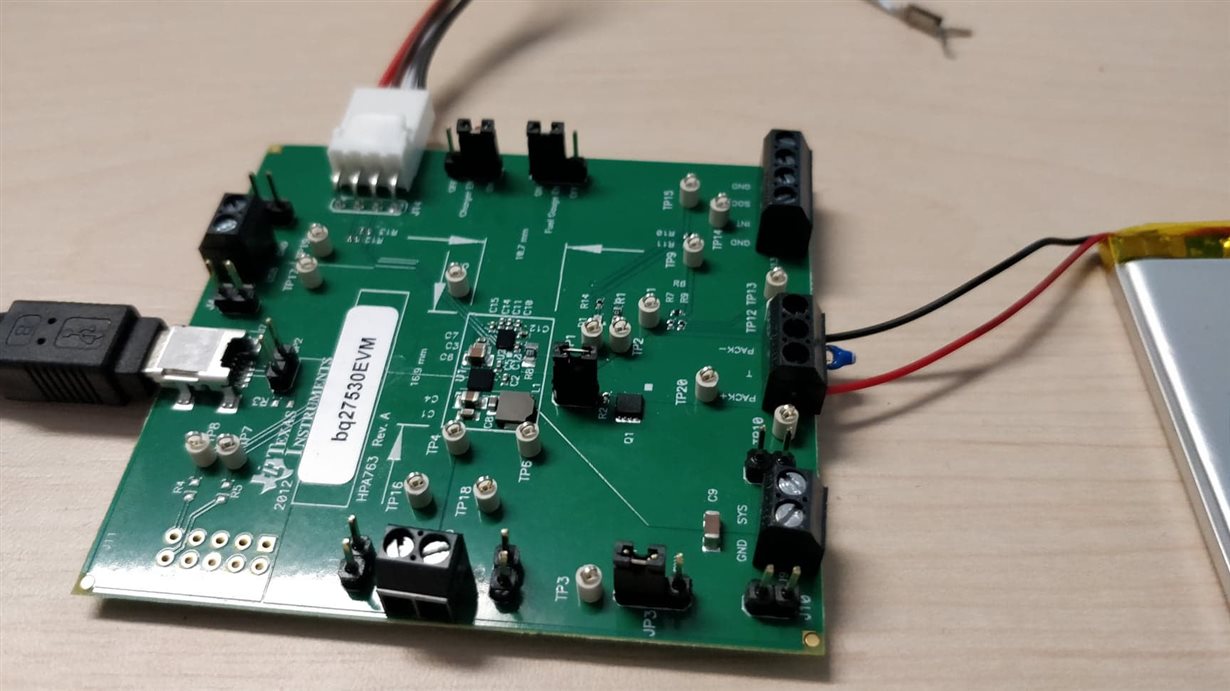

  • Hi
    As you can see from the photos I'm using the bq27530EVM board, with JP3 set to PSEL HIGH.

  • short jp2 with a jumper and move the jumper on jp3 to pins 2-3 (LO). This sets the in put current limit to 1500mA and will allow you charge with a higher current.
    thanks
    Onyx
  • I have tried shorting the JP2 with a jumper and run it with JP3 in both HIGH and LOW, but the outcome was still the same with a charging current of 80-90 mA
    Nicklas
