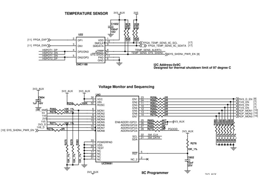

I am using UCD9081 for one of my application and i connected my temperature sensor output to MON8, it will be HIGH during normal operation and it will throw LOW once it reaches 97 degree. I want to switch off all the voltage rails ( Disable all the enables) till the temperature comes down (i.,e MON8 should HIGH).
Can you please suggest me the sequence to follow/ any training material/ any personal training to understand this chip better.
attached circuit for reference
