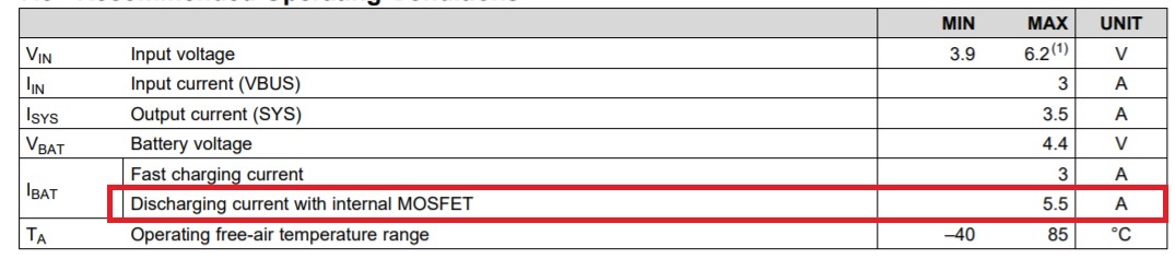

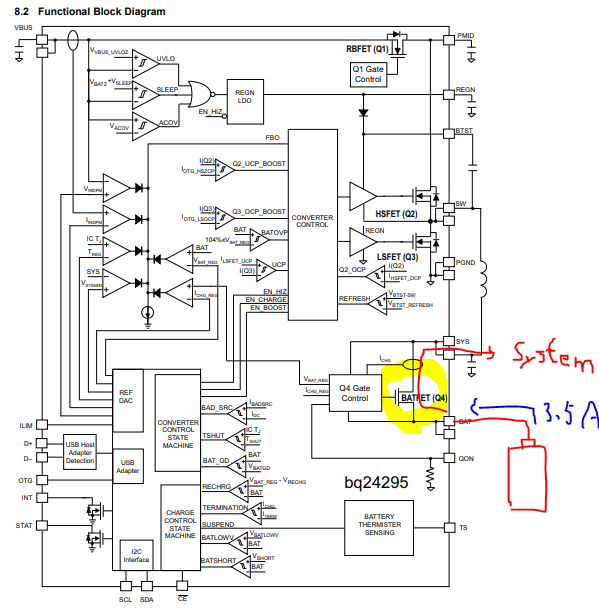

Our customer have a application that when use battery, the maximum peak current is 3.5A.
Could you let us know how much is the withstand current of Q4 in the BQ24295?
