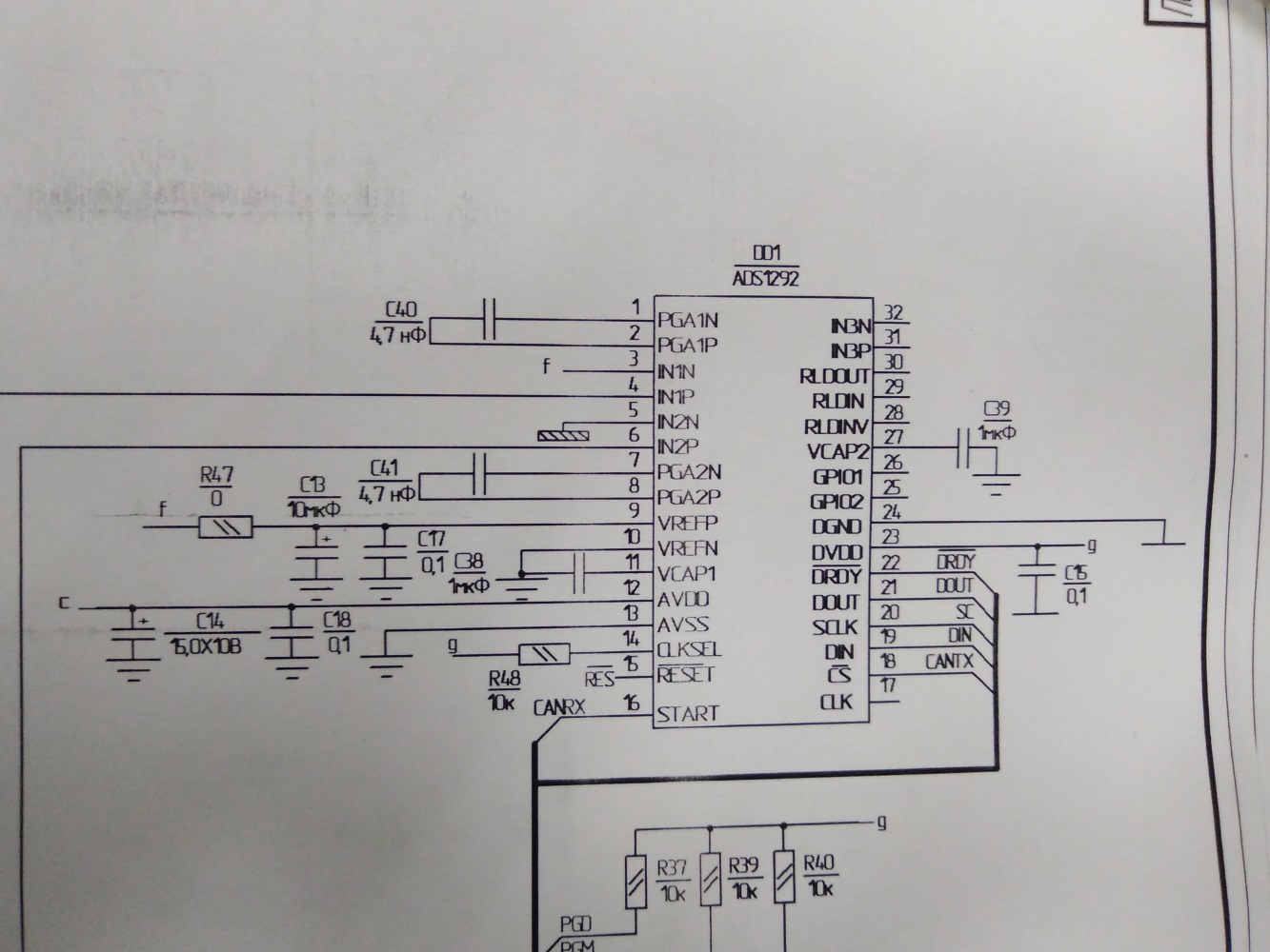

Hello. I use the ADC ADS1292 in my project. AVDD = 5V, DVDD = 3.3V, IN2P = 200mV. I configured this ADC first according to the "Quick Start" instruction in the datasheet. I get instead of real values ​​of 0x7FFFFF on both channels, the status bit is correct - 0xС00000. I tried to turn on the calibration - the result is the same. Here is the detailed code for initialization of this ADC in MPLAB x IDE:

I tried to disable the channels - I got a value of 0 on them, which means that the write commands are executed correctly. I tried to turn on the test mode to get at least some data (in the CH1SET register I chose 0101 = Test signal mode and set 0b10100011 in the CONFIG2 register) - still the same values ​​of 0x7FFFFF. Tell me, please, what could be the problem?
  • Hi Anton,
    Thanks for your post and welcome to the forums!
    7FFFFF is a positive full scale output and can be a result of an issue with one of these places: Analog inputs, PGA gain, reference, or output code conversion.
    What is the value of IN1P? 200mV as well?
    What is IN2N connected to?
    IN1N is left floating?
    On channel 2, assuming that IN2N is GND - a 200mV differential voltage multiplied by a PGA gain of 12 yields 2.4V which is your reference voltage. This would yield 7FFFFF as expected.
    Try increasing the internal reference to 4.033V to see if the extra head room on the ADC helps!
