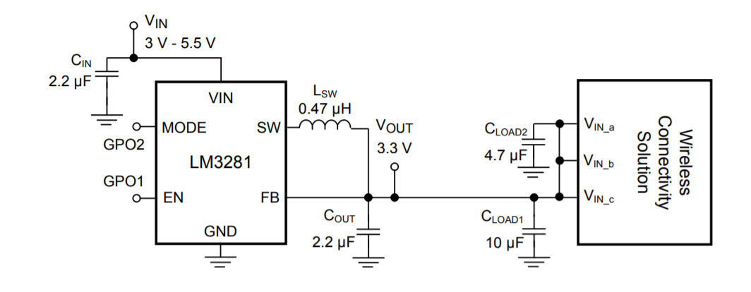

Good afternoon, my customer is interested in the LM3281 given the use of the small 2.2uF output capacitor. Do we have any graphs of load transient behavior using only the 2.2uF cap?
I noticed on the evaluation board that there is an additional 4.7uF and 10uF cap.
~John

    I have looked further into your request. It looks like the additional 4.7uF and 10uF caps are there to represent the capacitive load that is to be expected on the device. You can see this in the simplified schematic on the datasheet for the device.

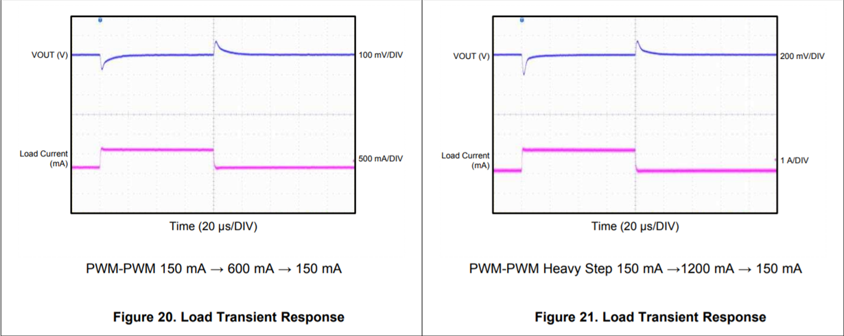

    The datasheet also states that the effective output capacitance should not be less than 3.4uF. I tried taking data with only a 2.2uF attached, but the data did not look good because of this. The datasheet has some load transient plots that were taken with the load capacitance from the schematic above that you can share with your customer.
