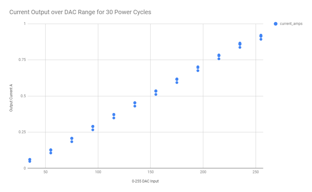

In the below chart you can see our normal linear operation above the faulty operation. We've noticed that the error is not percent based on our expected output but ~20mA decrease for every point.

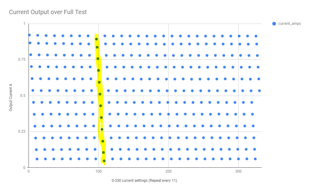

In this next chart I've graphed the current outputs over the course of the test. We cycle through 11 different DAC settings for every power cycle. We power cycle in this test 30 times. Note that the highlighted section of dots is the only one to exhibit the power drop error and during the next power cycle it has returned to proper output.

    During the test for the graph above, does this behavior change during the test? Are the results different for parts that exhibit this? When I look at the data points I see 12 per column and you have 11 DAC settings so is this during one power cycle and there are 12 data points or is this part of two power cycles? The regulation point changes only after power cycling and changes back after power cycling? I'm just confirming what you stated above.

  • Hey Irwin,
    The behavior only changes from power cycle to power cycle, never inside of the same power cycle. So if our first point comes up lower than expected we have observed the rest of the points for that power cycle to also come up low 100% of the time. Every power cycle is either a complete success or complete failure at every point within it.
    Excuse my typo, there is actually 12 control points we test during every power cycle. Sorry for the confusion.

  • Hello Tyler,
    So what is going on is the self calibration of the TPS92515. There are 5 mV adjustments to make the current regulation set-point more accurate. It allows an internal change of 5 mV per step. at full Viadj this would be 5 mV/240 mV or about 0.021%. At one amp average this is about what you are measuring.
