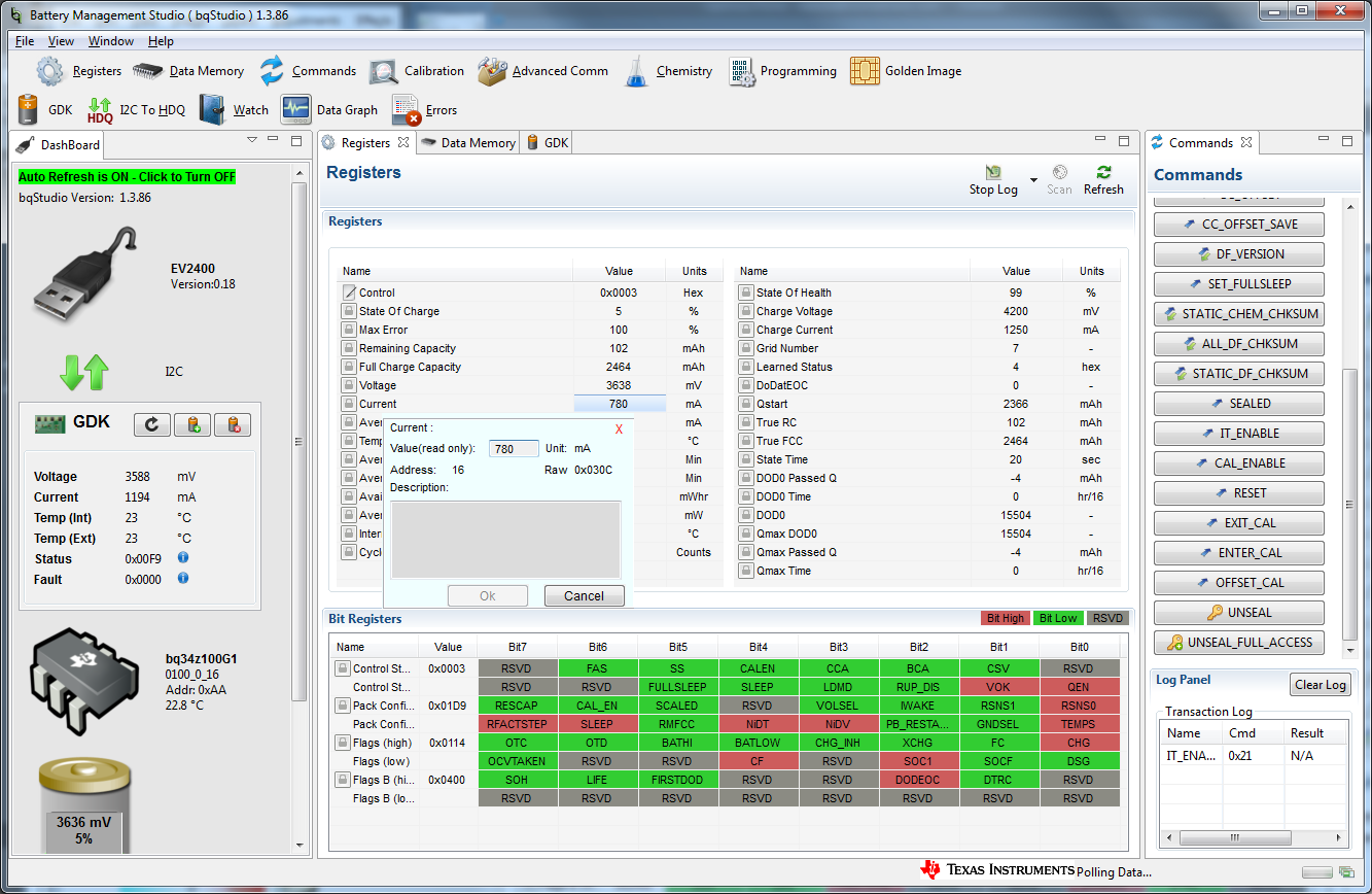

    Here is a screenshot of the two disagreeing. This is without a meter in series.  When I did have the meter connected and during calibration the gauge matched the actual current quite closely.
    The GDK measures 1194 mA of a 1250 mA set point and the gauge measures 780 mA.

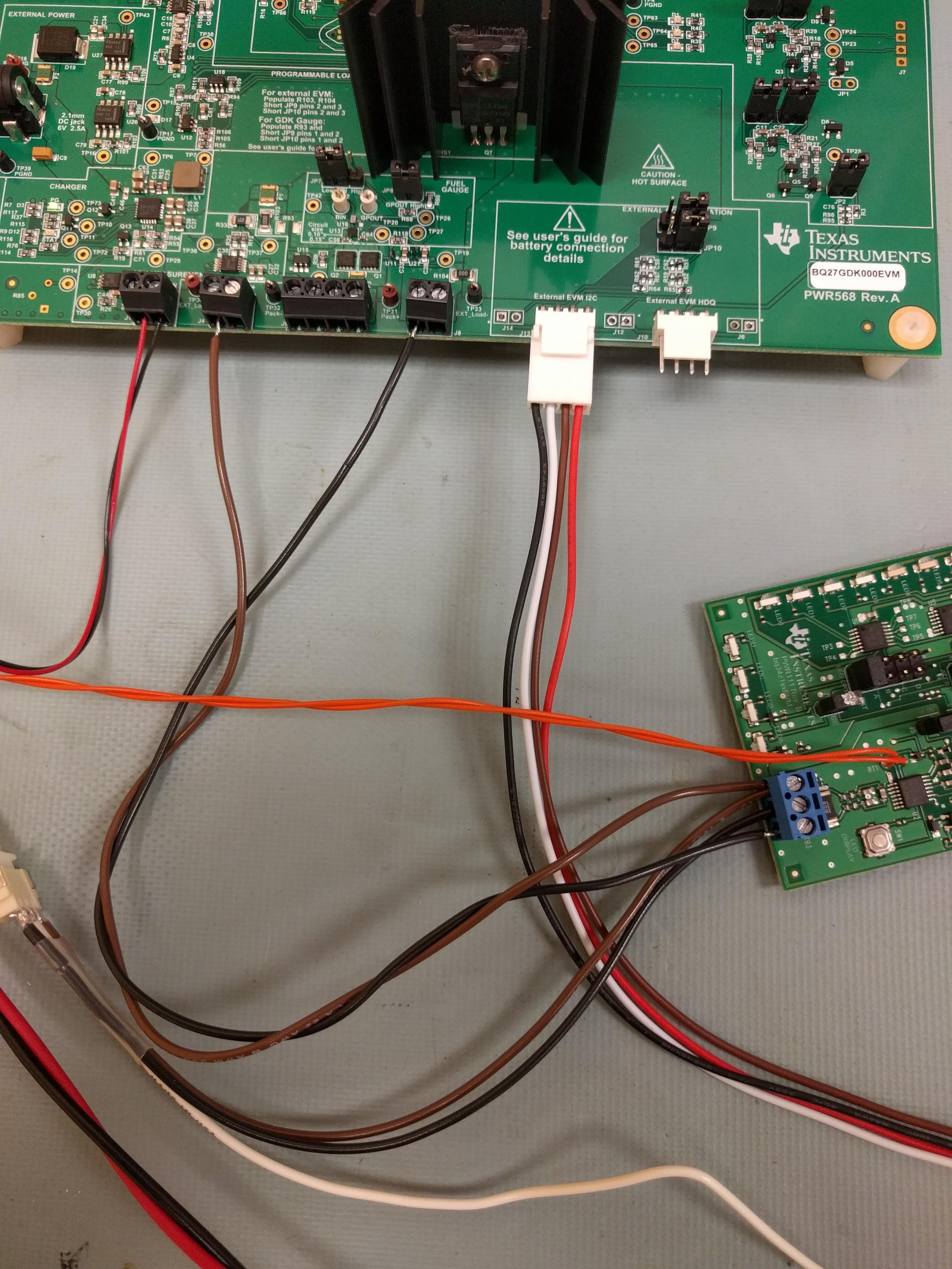

    Are J4 and J8 the correct place on the GDK to connect to Batt+ and Pack- respectively on the bq34z100EVM?
    How can I check the firmware version on the GDK microcontroller? (The EV2400 portion firmware is at the current 0.18 level). What is the current GDK firmware version?
  • Hi Steven,
    Can you please attach a picture showing all of your connections and setup? We just did a quick test and could get the gauge and GDK to report similar currents, although it did require calibrating the bq34z100EVM current.

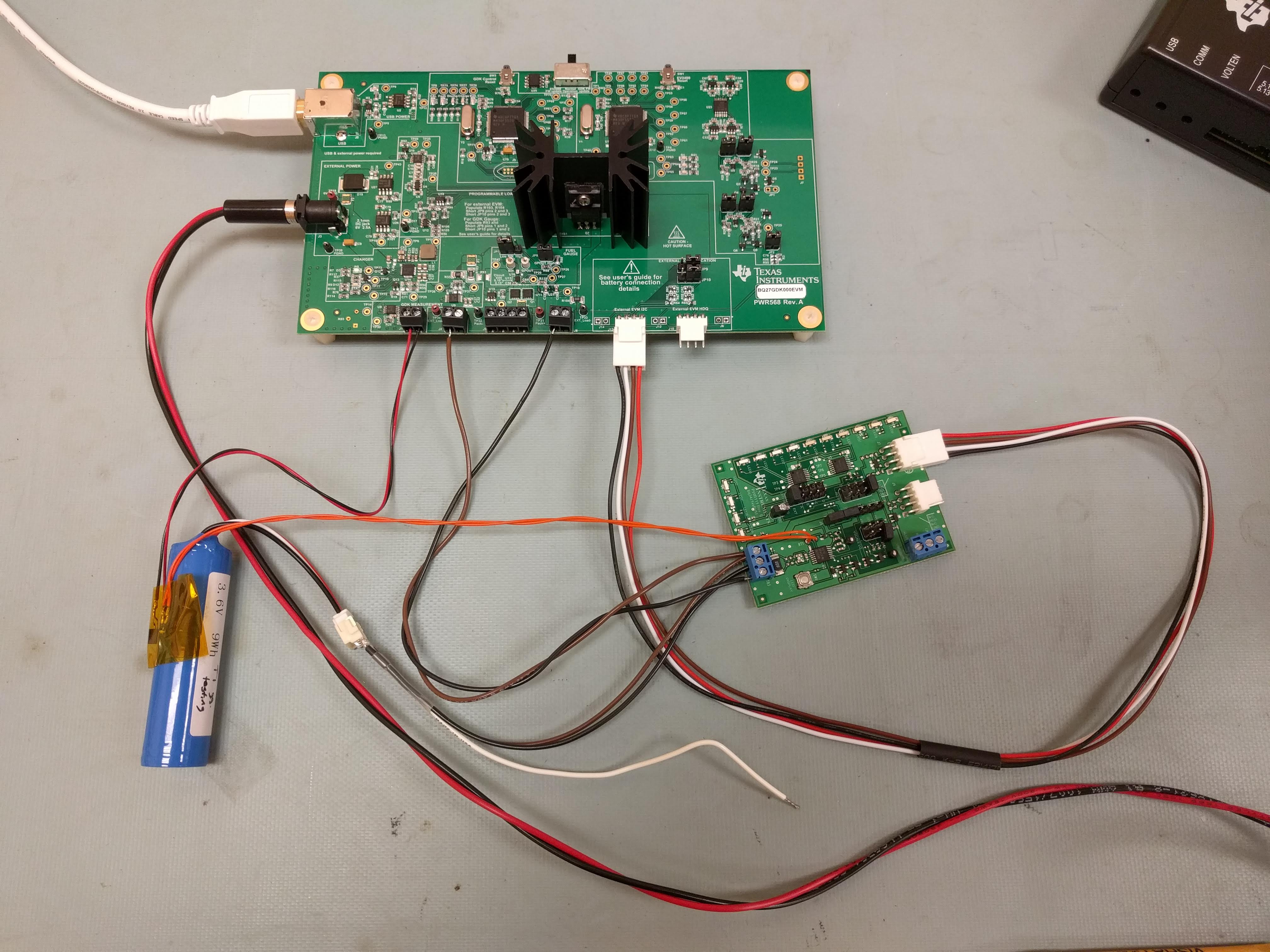

  • Here are photos of my setup.
    J4 on the GDK is connected to BATT+ on the EVM.
    J8 on the GDK is connected to PACK- on the EVM.
  • Hi Steven,
    Your connections appear correct.
    Is the molex connector between your battery and the bq34z100EVM using soldered connections or just inserted pins? The connection may not be so good if they are just inserted.
    Perhaps your ammeter is limiting the current or somehow influencing the measurement.
