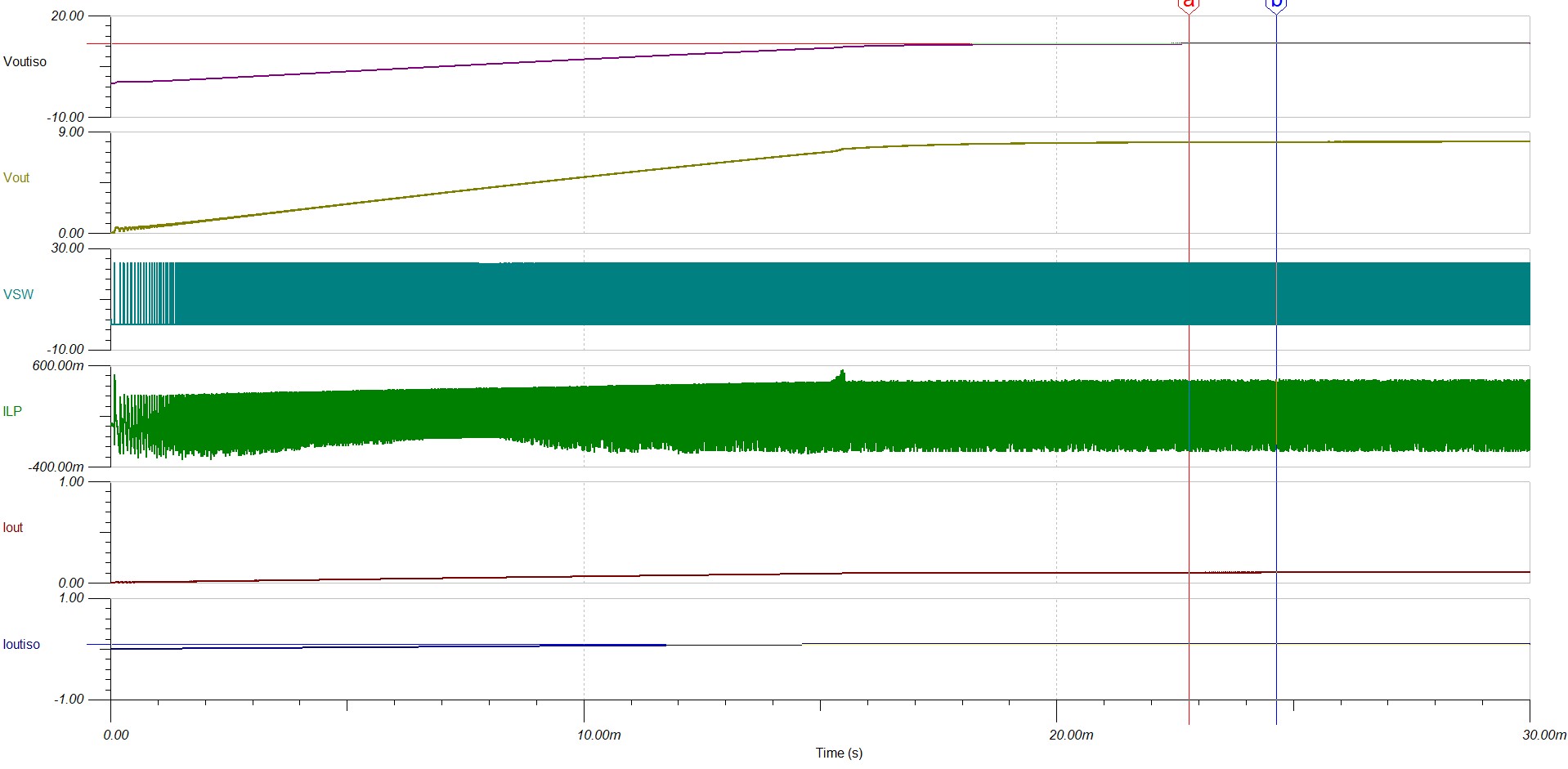

Could you double check if LM5160-Q1 could support above use case? Because I tried simulation with TINA-TI by modifying snvmb64.tsc, I could not get expected Isolated output.

    Here is a webench sample design for 300kHz. Also i attached the TINA model that you gave me and it seems it outputs 12V

    For example, Webench configurations are applied to original Fly-buck reference model of snvmb64.tsc, I can’t get target voltage with target current (400mA) with Vin_min(=6V) condition.

  • Hi Nobuo-san,
    1) Yes please be careful that the peak current on the High side current limit is not violated when you select the transformer, you might need a higher inductance transformer.
    2) I see that on your tina model, you have 1:1.5 turns transformer and your primary output is set at 8V, therefore at minimum VIN 6V, i believe that you are running into maximum duty cycle condition. Normally we try to run the Flybuck less than 50% duty cycle. You might have to probably use the Flybuck Boost topology to achieve this.
    -Arief
