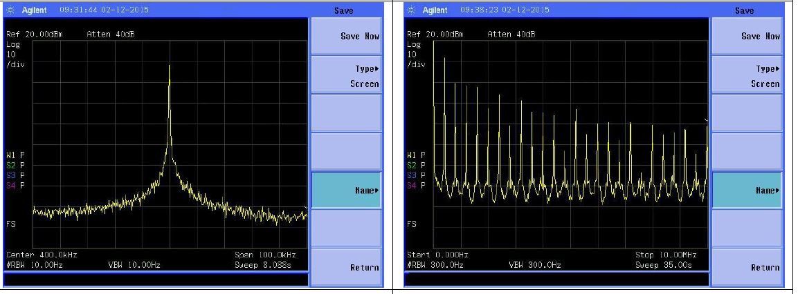

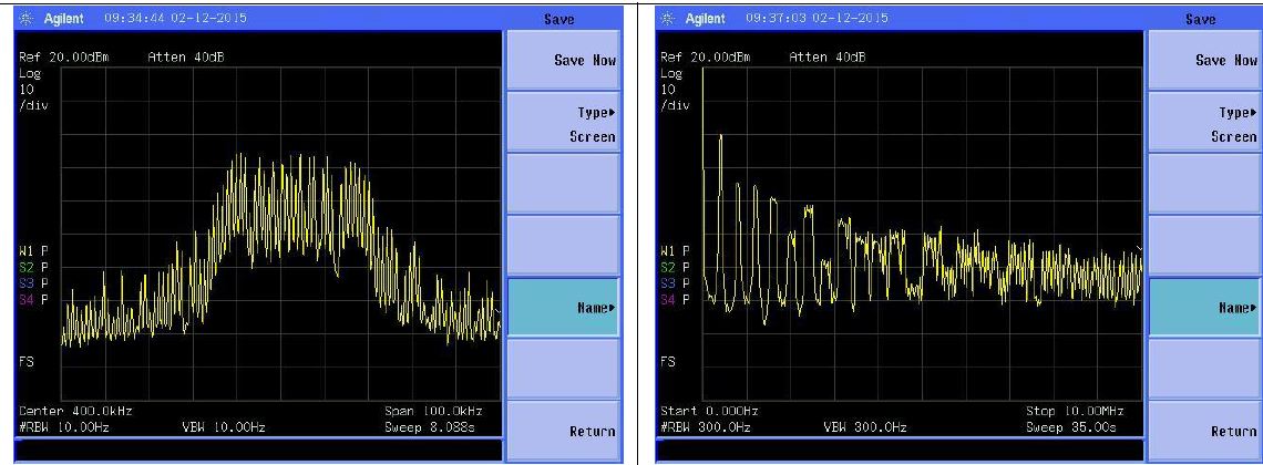

2. Efficiency of Spread Spectrum.
  They are considering to utilize Spread Spectrum function to reduce 2nd & 3rd
  harmonic within radio noise band(fSW = 400kHz).
  Please show the efficency of Spread Spectum ON/OFF using spectrum analyzer
  waveform, etc if you have.
H. Sakai
    1. Modulation frequency
    Thanks for pointing out this mistake. Please allow me some time to check which is the right one. But may I ask why customer is asking about the modulation frequency? Do they have any concern on this parameter?
    2. Efficiency of spread spectrum
    Below is the frequency spectrum of the device when spread spectrum is disabled/enabled. Fsw=400kHz.
    Disable spread spectrum:
    Enable the spread spectrum
