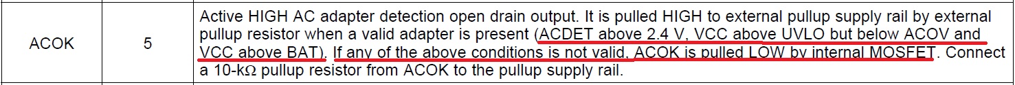

    May I ask one question, where is your ACOK pull up power source, is it from VRENG?
    For ACOK status, there is description in datasheet. I also captured in below for your reference.
    So if there is no power in VCC, then I think this ACOK will be unknow because BQ24780S didn't alive. So if your ACOK pull high is from Vreng then ACOK will still keep low because Vreng is also off.
  • Hello Paul
    No we are pulling ACOK to a source that is always high. Thanks for the answer, will try to see if we could pull up ACOK differently.
