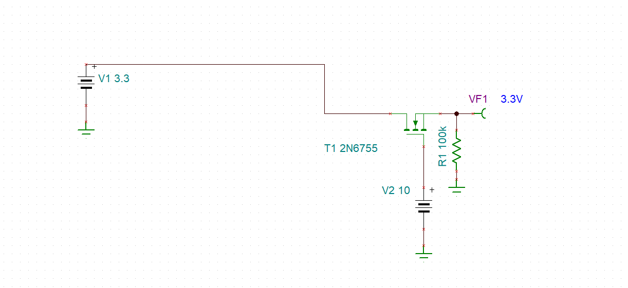

Q3: Can I use NMOS CSD13302W to switch a 3.3V voltage? Like the attach. 2pin is 3.3V/60mA input. 3 pin is 3.3V output. 1pin is controlled by MCU,
If this can be achieved, would you send me a correct circuit or a TINA circuit?

    3. In the diagram of the NMOS you have the body drain diode polarity incorrect. The Cathode of the diode needs to be connected to the DRain of the MOSFET, not the source. This means the drain and not source would be connected to the +3.3V. As long as the gate of the MOSFET is +ve with respect to the source the device will conduct, in the case of the CSD13302W the min voltage this needs to be is 2.5Vgs to guarantee the device is on with a certain level of resistance. If your MCU can provide a Vgs voltage of 2.5V then it should be fine, actual voltage MCU will need to provide will need to be ~6V as when the FET conducts will will be nearly 3.3V on the source , so 2.5V+3.3V is needed to keep the part on, if you do not have a floating gate drive pin to drive the gate of the FET. If this is not possible many people use pch devices in a configuration shown in the diagram below

    Q2: I do a test circuit with TINA. S pin is floating in this circuit. D pin is 10V. G pin is 5V. Then I can get 10V in the S pin.
    So, I can keep S pin be floating in the circuit to achieve this function, correct?
    I do another circuit, please check the below attach:
    I think this design is the better than S pin is floating. What is your suggestion?

    I spoke with an application engineer and got the following response:
    If the customer wants the FET to block, the gate to source needs to be below the Vth and the source to GND impedance need to be much smaller than the equivalent drain to source impedance of the FET.
    For this case, you need to have Vg=0V, and source to GND impedance to be ~100kohm, like you have in the 2nd circuit
