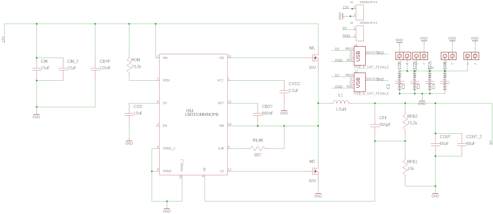

LM3150: LM3150 switching between 5.5V and 7V using reference design
Part Number: LM3150
I used the TI Power Designer and put in 12V minimum, output 5V 15A and used the LM3150 reference design. I imported it into Eagle and layed out the board and have assembled 3 of them and they all exhibit the same behavior. Measuring output I get 5.5V to 7V oscillating over about 2-3 seconds. The 4 large caps aren't installed, so ignore those. Any ideas?
