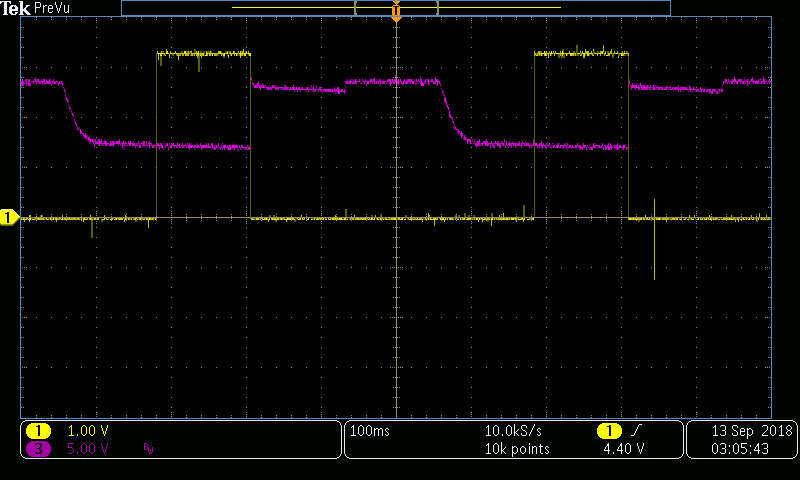

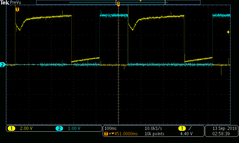

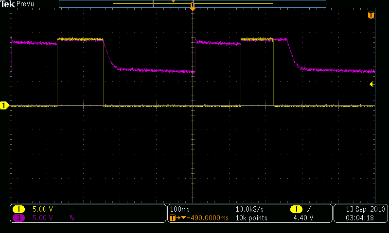

  • Hi, I wrote some code where I'm sending alternating LI and HI pulses, with 0.125ms dead time between; the pulse widths are 0.125s.
    When the LS switch turns on, HO is pulled to ground. I hoped this would allow Cboot to charge when the LS is on, but I'm still having the same issue. As soon as the LS switch turns off, HO spikes to the HS switch drain voltage, and then settles quickly to VDD/2.
    Cboot = 270nF
    Rboot = 4.7Ohm
    See attached Figures.
    Fig 1: Yellow = VHO, Blue = LI
    Fig 2: Yellow = LO, Purple = VHB-VHS
    Fig 3: Yellow = HI, Purple = VHB-VHS
  • Sorry, type -
    Fig 1: Yellow = VHS, Blue = LI.
  • After simulation, removing the GS resistor of the HS switch resolved the issue. The resistor was proving an additional discharge path for Cboot.
  • Hello Matthew,
    Thank you for the feedback and scope plots.
    I see that you are running low frequency during your tests, so we need to consider that for your application. Also to get a better idea how to resolve the issue I will ask you for some additional plots to be able to comment on how to resolve the issue.
    Since you are running with long on times for the driver outputs, can you provide the component values for the HB to HS bootstrap capacitor, resistor value of high side MOSFET gate to source resistance (if any), and the VDD capacitance? Also what is the VDD voltage to the UCC27712?
    Refer to the UCC27712 datasheet section 9.2.2 for guidance on selecting the bootstrap capacitance and VDD capacitance. Since the frequency is low, be sure to consider the HB quiescent current as this will discharge the HB-HS capacitor. Also the gate to source resistance will discharge the HB-HS capacitor. So if you have gate to source resistors on the high side FET, you may want to try removing this resistance.
    For the waveforms to determine what is going on with the drive signals, and HB bias can you capture additional plots?
    If you probe HO to ground what you are seeing is the combined voltage of HO-HS and HS to ground. To clarify take some additional plots.
    1) HO, HB, HS, and HI. Take on the same voltage scale with HO, HB and HS with the same ground reference location, that will clarify what each signal is doing with respect to HS.
    2) LO, HO, HB, and HS. With HO, HB, HS same scale and ground reference.
    3) HI, LI, LO, HO
    If is not clear what HS is doing and also HO relative to HS from the scope plots so far. We can resolve the issue with a little more investigation in the details.
