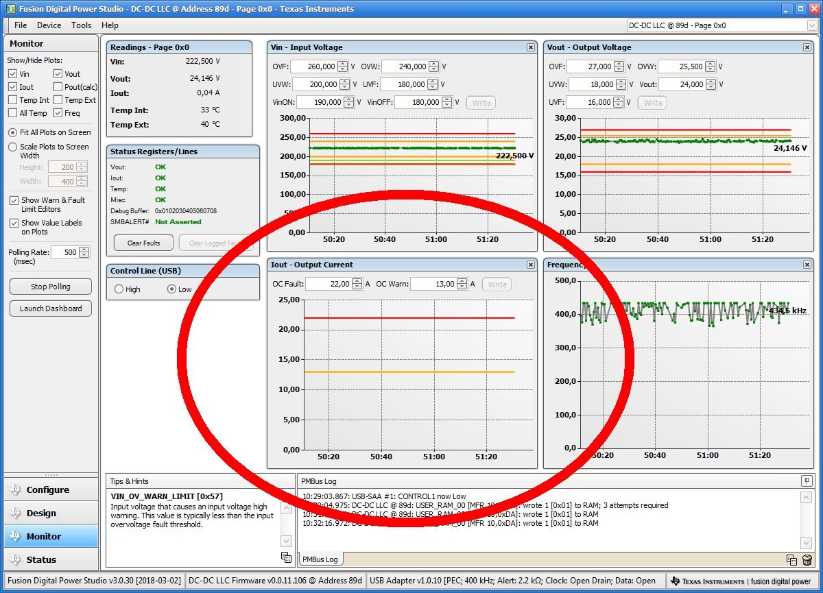

UCD3138: Fusion Digital Power Studio iout is not displayed in the tab Monitor (DC-DC-LLC UCD3138a)
Part Number: UCD3138
Hallo
my log Messages Shows
10:48:24.473: DC-DC LLC @ 89d: READ_VIN [0x88]: read 221,750 V [0xF377]
10:48:24.478: DC-DC LLC @ 89d: READ_VOUT [0x8B]: read 24,070 V [0x3024]
10:48:24.479: DC-DC LLC @ 89d: READ_IOUT_ALL [0x8C]: error reading: INVALIDARGUMENT
10:48:24.492: DC-DC LLC @ 89d: READ_IOUT [0x8C]: read 0,45 A [0xAB94]
10:48:24.500: DC-DC LLC @ 89d: READ_TEMPERATURE_2 [0x8E]: read 40 °C [0xE
The command Read_iout_all is use in the tab Monitor .
Is it possible to change the invalid command in a setup-file?
Thanks in advance
