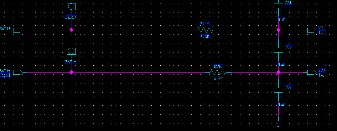

  • Thank you for your reply!
    The input filter circuit of the battery is also damaged. The recommended parameters for the EVM are 1k (resistance) and 1uF capacitance.
    If you change the resis tance of the 1k to 3.3k will improve?
  • Hi Tony,
    BATT- to VC0 should normally be 0V, as would the voltage across the NT1. If the filter components have been damaged it would be good to find the cause of the large voltage and prevent it.
    The maximum value recommended in the bq76940 data sheet for the Rc filter resistor is 1k. Larger values would likely work but may start to show some error during measurement of the cell. The filter capacitor value may vary, the filter should be able to settle before measurement starts on cell 1 during balancing. The 1uF 1k combination will show some voltage error on the lower cells, a smaller capacitor is suggested.
    The VC1 capacitor should be connected to GND rather than VC0 as shown in the data sheet figure 8-3. The connection shown above has unfortunately been shown in some schematics and does not seem to have caused problems in those circuits, but it is not recommended.
