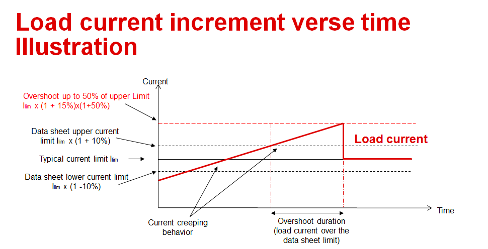

    What is your typical and maximum load limit? Are you trying to run your load at 650mA and set the current limit to the same spot?
    I believe what is happening is that your max load is where you are trying to limit the current but the current limit should be higher than your maximum load and then there is some overshoot and then it clamps back to the limit of where you set it.
    This picture describes what I am talking about. Let me know if this answers your question.

    And then, we assume that this device has two thresholds which are "over shoot" and "over load".
    Over shoot : Overshoot up to 50% of upper Limit  Ilim x (1 + 15%)x(1+50%) -> 0.625×1.15×1.5 = 1.078A
    We got "Over shoot" and it clamps back to the limit of where we set it.
    However, we could not understand "Over load" correctly.
    We recognize that "Over load" means the clamp current.
    Is it correct?
    How much is the tolerance?  Typical load limit × 1.2? or 1.3?
    Customer's mesurement result of clamp current was 750mA.
    So, actual result=750mA / Typical load limit = 650mA -> 15%, is it approxy ±15%?

    Could you please provide a waveform of the event that you are referring to? I do not understand how you are differentiating over shoot and over load. Are you saying that the current goes up to 750mA and then clamps back down to 650mA? If so that is the intended way and aligns with what the datasheet says of up to 1.5x the current limit.
