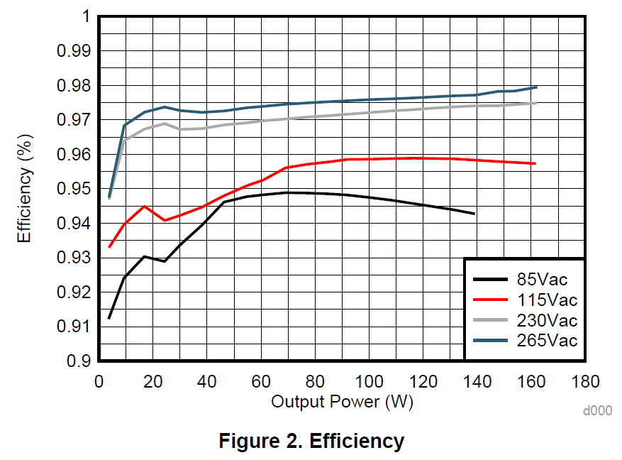

I could see the efficiency curve in the UCC28056 file as below.
Could you tell me the auxiliary power loss is included when draw the efficiency curve?

Hi Eleven,
The auxiliary power loss was not included in the power loss curves.
