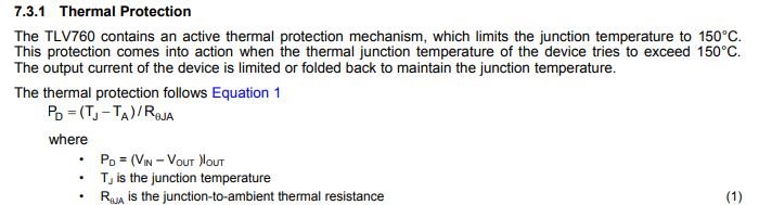

We have a question about TLV760.
Please tell us the method of overcurrent detection.
TLV760 monitors current or temperature?
We want to know how to detect overcurrent and protect the IC.
Takahiro Nishizawa
  • Hi Takahiro,
    The TLV760 monitors the junction temperature of the linear regulator.  As the junction temperature increases, the regulator will actively reduce (limit) the output current so that the junction temperature remains approximately 150 C.
