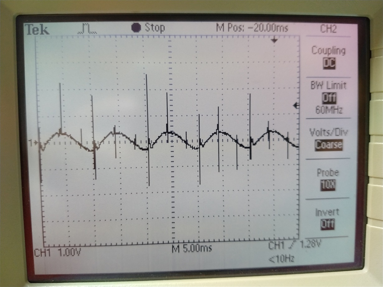

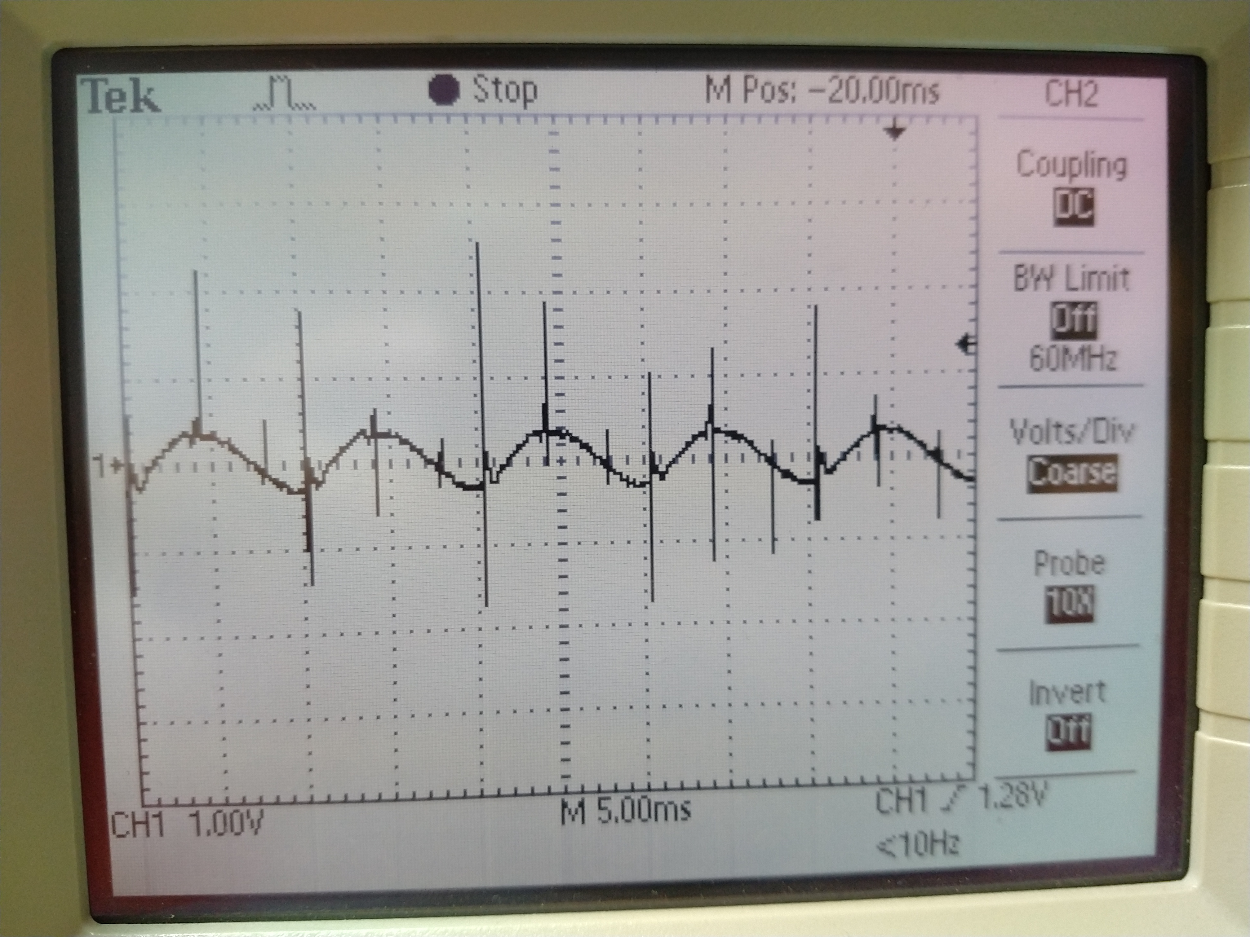

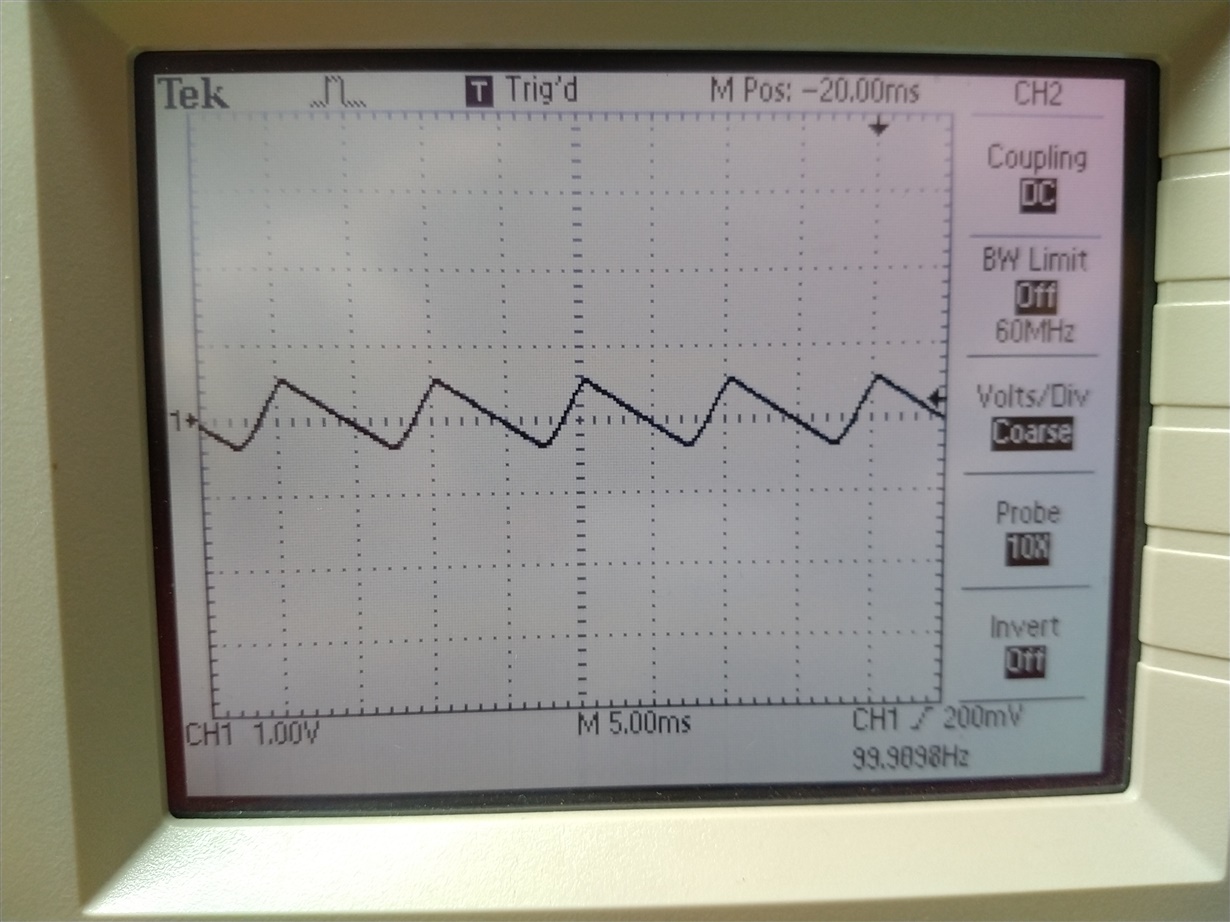

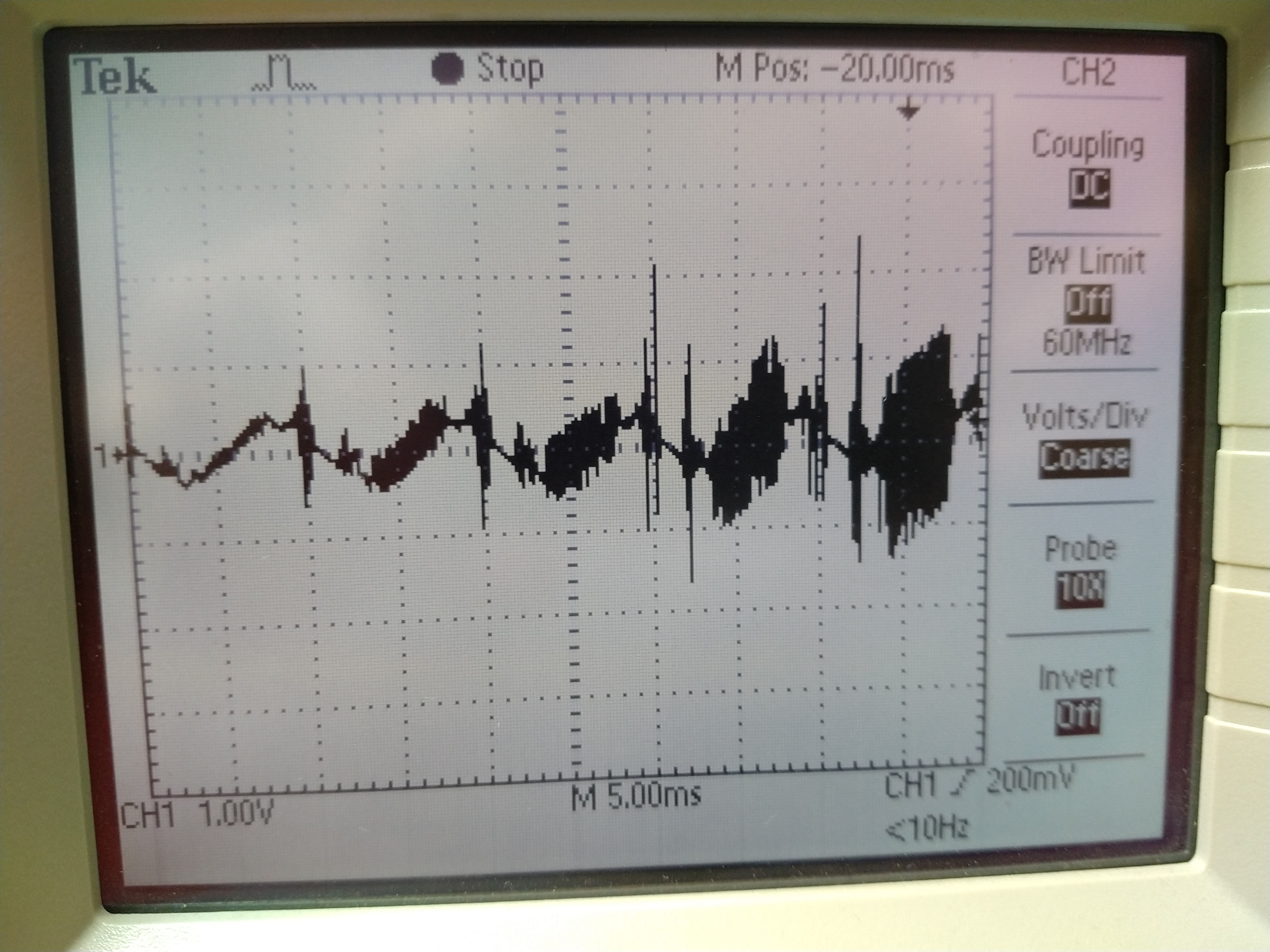

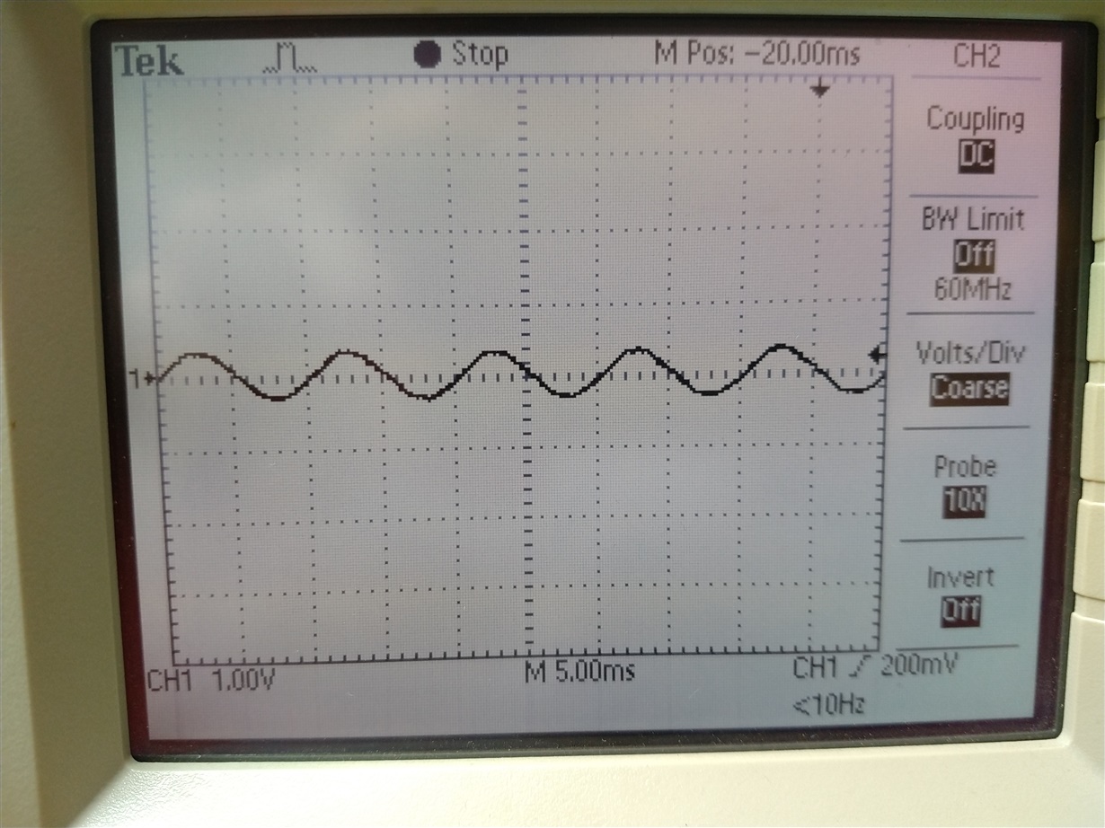

My PFC prototype using UCC28070 is alive in the sense that it regulates the loaded output to the desired +90V voltage. The DC output signal has a ripple of about 1 Vpp and the ripple has the shape of a 100Hz sinewave. However, there are spikes of a few voltage in amplitude appearing on the output signal. These spikes appear periodically every second or so, which means that the output signal varies from perfectly clean to very noisy. See various pictures in attachment showing the noiseless or noisy output.
I measured the GDA and GDB chip outputs and I can see that the duty cycle of the PWM is not stable. With a 12 Ohms load (90V across it), the two GDx signals vary from about 50% duty cycle to about 30% duty cycle on both GDx outputs. See video in attachment. The variation seems cyclic too and I would say it has a similar period as the spikes appearing and disappearing on the output.
Is this the sign of an instability of the compensation around UCC28070?

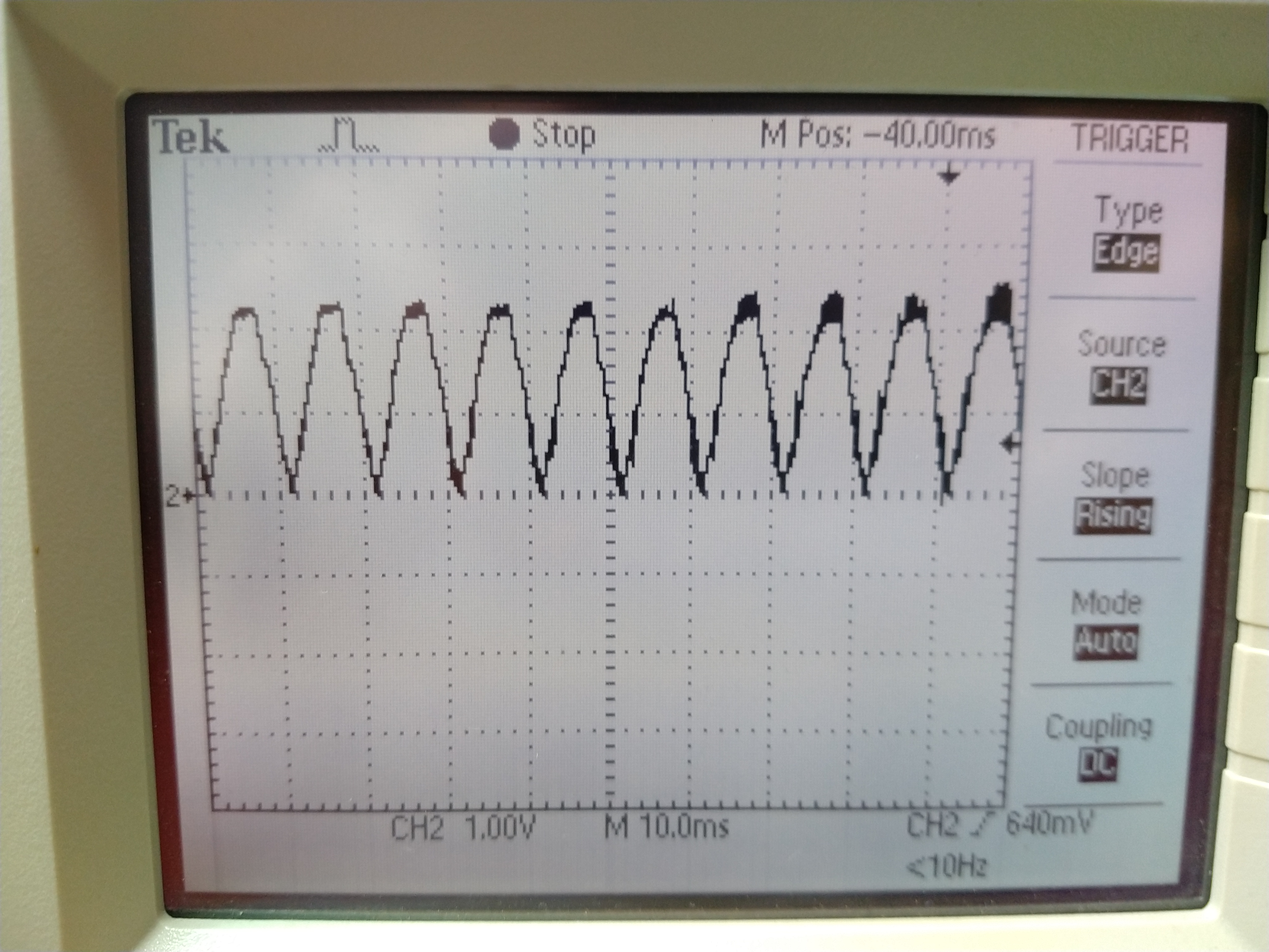

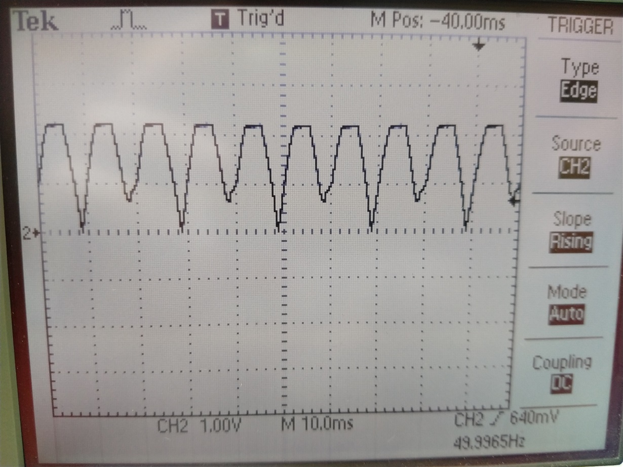

besides, the measured VINAC signal has not got the perfect shape of a rectified signal. Every other one cycle, the voltage doesn't go back to zero but stays at about 0.6-0.7V before going back up. See icture in attachment. Could the chip prevent the signal from going back to zero? See picture in attachment.

  • Noiseless output (AC coupling)
    Randomly noisy output (AC coupling)
    Noisy output measured at a different moment
    output signal with UCC28070 disabled (simply the diode bridge rectification, AC coupling measurement)
    VINAC with UCC28070 disabled
    VINAC with UCC 28070 enabled
