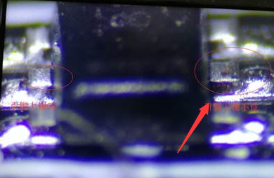

       Look at the below picture, the both sides of pins have  packaging materials. Is it normal ? Does the packaging process require removal of these packaging materials ? Because it will stop to sold the both sides of pin .

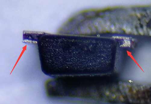

       And the second below picture, the bottom of pins tin plated which are not smooth, the reflection brightness is inconsistentis, is it normal ? why?
  • this looks to me to be the tin coating.
    It is normal is is not shinning, it is MATTE tin

    1)      Concern: “Packaging material on both sides of the leads” as per customer photo (figure1) below:
    Figure 1: customer photo: arrows pointing to mold flash in the side of the lead
    Assessment: The package material on the sides of the leads is so called “mold flash” and is part of the normal manufacturing process. Mold flash on the side of the lead does not impact quality or reliability of the soldering interface that is established on the bottom side of the lead.
    2)      Concern: “the bottom of pins tin plated which are not smooth, the reflection brightness is inconsistent” as per figure 2 below:
    Figure 2: customer photo showing inconsistencies in the reflection and brightness on the bottom of the lead.
    Assessment: The leads are plated with matte tin (Pure Sn) which is a relatively soft material. The inconsistency in the brightness of the bottom lead side is coming mainly from the insertion of the device into the test socket during the final test operation where the lead is contacted from the bottom side. The appearance of the leads shown in figure 2 above is considered normal and is no concern.
