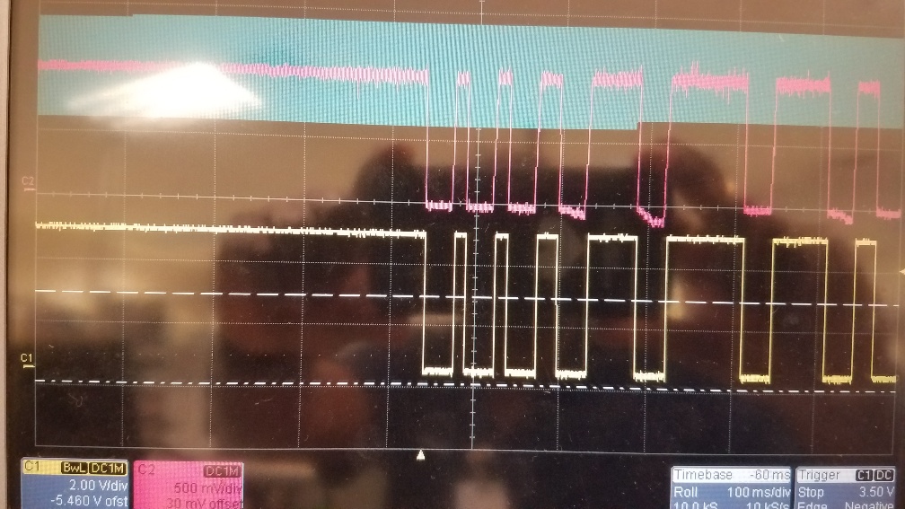

    OV and UV are not masked and also PG is not masked. The ignore fault is only applicable to the Margin levels. Here is an example with Ignore on fault set and short on the output. Same scenario with OV on output.
