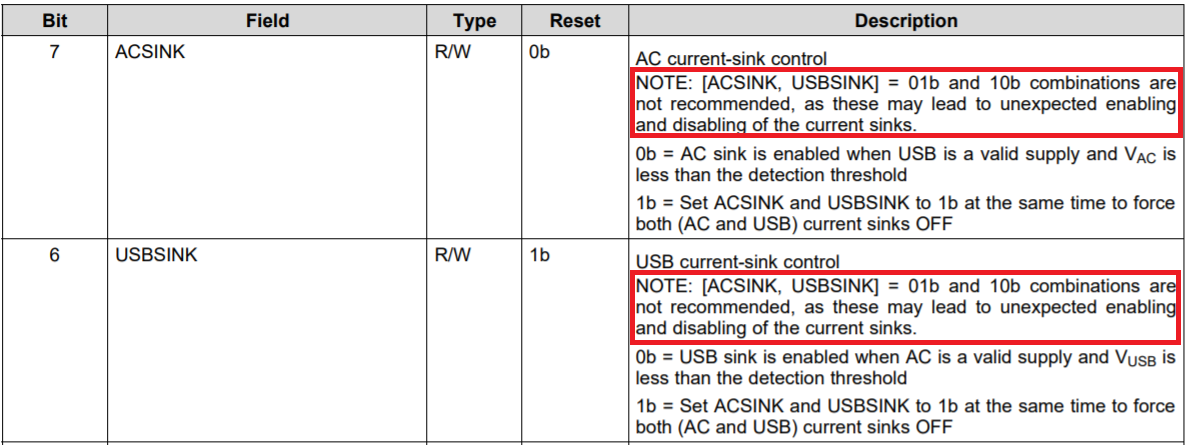

About P46 "PPATH register" in the data sheet.
The initial value of "USBSINK" is "0 b" in "Figure 31" but "1 b" in "Table 3".
Which is right?
<Question from me>
I think "0b" is correct from the following description of the data sheet.
Is my considering correct?
Could you help me?
