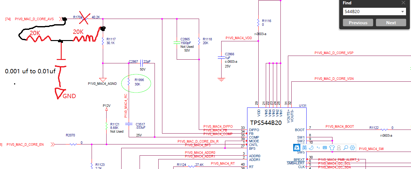

Hi Sir or Madam,
We met a problem in using TPS544B20. There is a glitch on PGOOD which is causing the system reboot. From the datasheet, the PGOOD windows is +/-12.5% as default value.
May I ask how the IC internally sets this +/-12.5% window? which signal (or signals) is used? Is it using the FB pin voltage and comparing with a reference voltage?Per the below waveform, seems the PGOOD is asserted before the output voltage is really out of +/-12.5% window?
