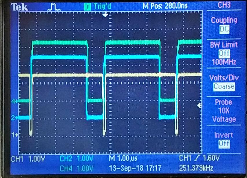

I was testing IDE_KD bit of FaultMuxRegs register of UCD3138. To test it, I configured DPWM0 and DPWM1. DPWM0 gets its duty from Filter and for DPWM1, CLA is not enabled. Both DPWMs are in normal mode.
DPWM1 duty configurations:
Dpwm1Regs.DPWMPRD.all = 16000;
	Dpwm1Regs.DPWMEV1.all = 0;
	Dpwm1Regs.DPWMEV2.all = 0;
	Dpwm1Regs.DPWMEV3.all = 0;
	Dpwm1Regs.DPWMEV4.all = 16000;
With this configuration, I expect 0% duty cycle and continuous on DPWM1B.
To get duty of DPWM0, I configured Filter out clamp registers as:
            Filter2Regs.FILTEROCLPLO.bit.OUTPUT_CLAMP_LOW = 15520;
            Filter2Regs.FILTEROCLPHI.bit.OUTPUT_CLAMP_HIGH = 15520;
With this configuration, I expect 97% duty cycle.
I enabled both IDE for DPWM0 and DPWM1 and I set IDE_KD bit as 400. At the end, I observed the scope screen below where yellow is DPWM0A, blue is DPWM0B and green is DPWM1B.
My questions are:
- With this configurations, DPWM0A and DPWM0B pins are on at the same time which leads to cross conduction of two complementary FETs. Is there any method to eliminate this problem?
- DPWM1A has 0% duty cycle. How is DPWM1B duty calculated without any duty of DPWM1A? The reason why I am asking is this, it is written as "Db is calculated by Da (Filter Duty) times IDE_KD" in Technical Reference manual in page 233.

  • I now realized that if I clamp Filter outputs at most 15459, this faulty situation does not occur. But why, does it mean that I should not make my transistors on at 97%.
    Also, if I set IDE_KD = 5000, Filter output can be at most 15473. After that, again this situation occurs.
  • I am not sure. We will need to run a test in order to verify this. One of us will get back to you.
  • Please note, IDE_KD is in 4.9 qnote format, with the integer portion of the KD value ranging from 0 to 15 and 9 fractional bits.
    So the largest number that it can represnt is 15.99 ~ 16.
    If the sum of  (IDE_KD * FILTER_DUTY) + dead_time1 + deadTime2 is larger than the period, you will encounter a shoot through.
    So yes, depending on your dead times, you have to limit the (IDE_KD * FILTER_DUTY) not to exceed certain percentage of the period.
    Regarding DPWM1 that is conmfigured as open loop. To do IDE, you still need to connect to filter and have the output of filter to stay fixed at certain value to acheive open loop. In other words, CLA_EN in DPWM1 needs to be enabled in order for the IDE to function. DPWM1 still multiplies IDE_KD and FILTER_DUTY.
    FILTER_DUTY is dictated by the filter that is connected to DPWM1, there is no other way to force the value of FILTER_DUTY.
