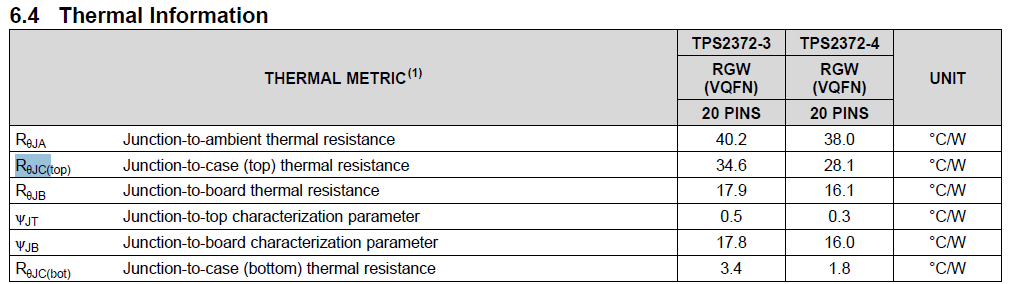

My customer is looking for TPS2373's maximum power dissipation.
Can you help on provide the information?
Not junction to case thermal resistance:
I am looking for maximum power dissipation:
Best Regards

Hi Kevin,
Majority of the dissipation of the ic will be from the internal pass fet and vcin/vcout current ( which depends on the pwm controller that's paired with the tps2373). Please see below link that describes this in general for our pd controllers.
