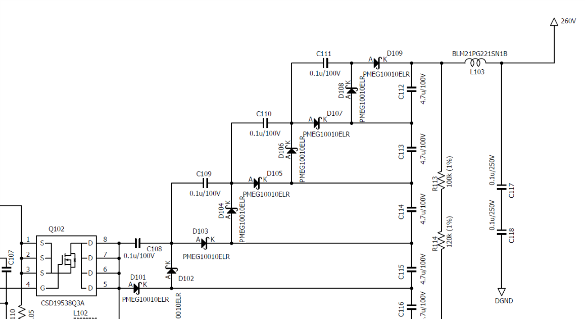

Our customer refers PMP20183 to design the circuit for following requirement.
V_INPUT : DC 9V
V_OUTPUT : 260V (Max)
I_OUTPUT : 10mA(Max)
According to the requirement, PMP20183 looks to be good reference design while a little change might be needed.
So, what should we modify PMP20183 to meet the requirement?  Could you please tell us your view?

  • Hi
    To achieve Vout=~260V,  I think the charge pump circuit should be added.
    I attached sample schematics using charge pump with N=5. (Not tested)
    260/5 = 52V, so we will adjust output of LM5481 for 52V.
    Is this understanding correct?
    Is it is correct,  what should be considered for adding charge pump?
    And switching frequency will be adjusted as you mentioned.

  • Hi na na 78,
    The duty cycle calculation is correct, but it is only valid when the circuit operates in CCM.  If the circuit is designed in DCM, the required duty cycle is determined by:
    D_DCM = sqrt ( 2x Fs x Lm x Po ) / Vin
    Where Fs is the switching frequency, Lm is the boost inductor, and Po is load power, and Vin is the input voltage.  It shows that smaller the Lm the smaller the duty required.  However,  smaller Lm also leads to higher peak switch current.  This is why in the PMP20183 the designer uses additional charge pump.  I believe the number of charge pump stages in the PMP20183 should be enough.
    Youhao

  • Hi
    Should I calculate with Po=260V x 10mA = 2.6 ?
    The customer is asking how to calculate Po in PMP20183.
    I believe Po could be calculated by 260V x 10mA, but could you please tell us your calculation to avoid misleading of customer?
    BestRegards
    Yes, you are right: the output power is the output voltage x the output current. However, in this ref design, the Po should be the boost stage output power, which also includes the power losses of the charge pump. As a quick estimate, use 50% as the efficiency, then your Po in that formula would be 5.2W.
